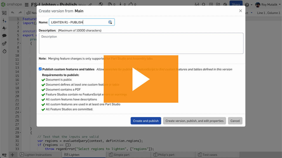

    You might want to look at the "official" publishing recommendations for custom features.
    https://forum.onshape.com/discussion/22767/please-publish-your-high-quality-custom-features
    9b158cd1b3d0cf3a6ffa5d59ff3c0f1980ed4101.jpg?image_play_button_size=2x&image_crop_resized=960x540&image_play_button=1&image_play_button_color=f88701e0
