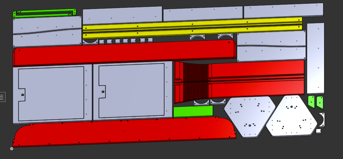

The script is indeed very process heavy (laggy) as there is no way to perform the necessary processing without also creating and deleting entities as reference using featurescript. However it is quiet powerful:
I like this example as it would be very time consuming for me to space these parts using sketches as references but using this script it takes just a few seconds. Parts don't have to be flat either all that matters is you select the plane you want things to be spaced on:

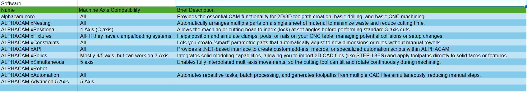

    @christopher_dziuba I'll follow up via email for sure but while I'm here in the forum on my professional account I'll leave a few more breadcrumbs for the next woodworking CAM person to follow. I just had an Alphacam territory manager reach out the other day and ask me which modules I needed and here's what they said they had:

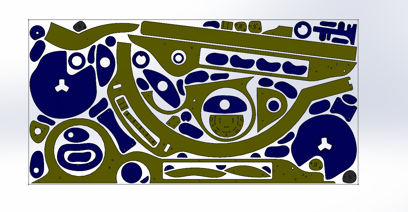

    Of which I said I'm for sure going to need xAutomation, xSolids, xNesting and probably xAPI. I haven't yet seen their demo for working with my parts (scheduled for next week) but I'll be comparing to how CAMWorks / NestingWorks has been for us where it's able to nest and program sheets that look like these in under 15 minutes:
    I did tell them that I'm heavily interested in their xAPI module in particular because the amount of manual data organization that goes into managing a monthly workload of a thousand sheets that look just like this full of brand new unique parts is ripe for automation the whole way through the stack. A large part of our drafters' responsibilities at the moment are simply copy and pasting information into different locations, would love to hear more about your app because I'm sure there's some significant overlap with what I'm about to do.
