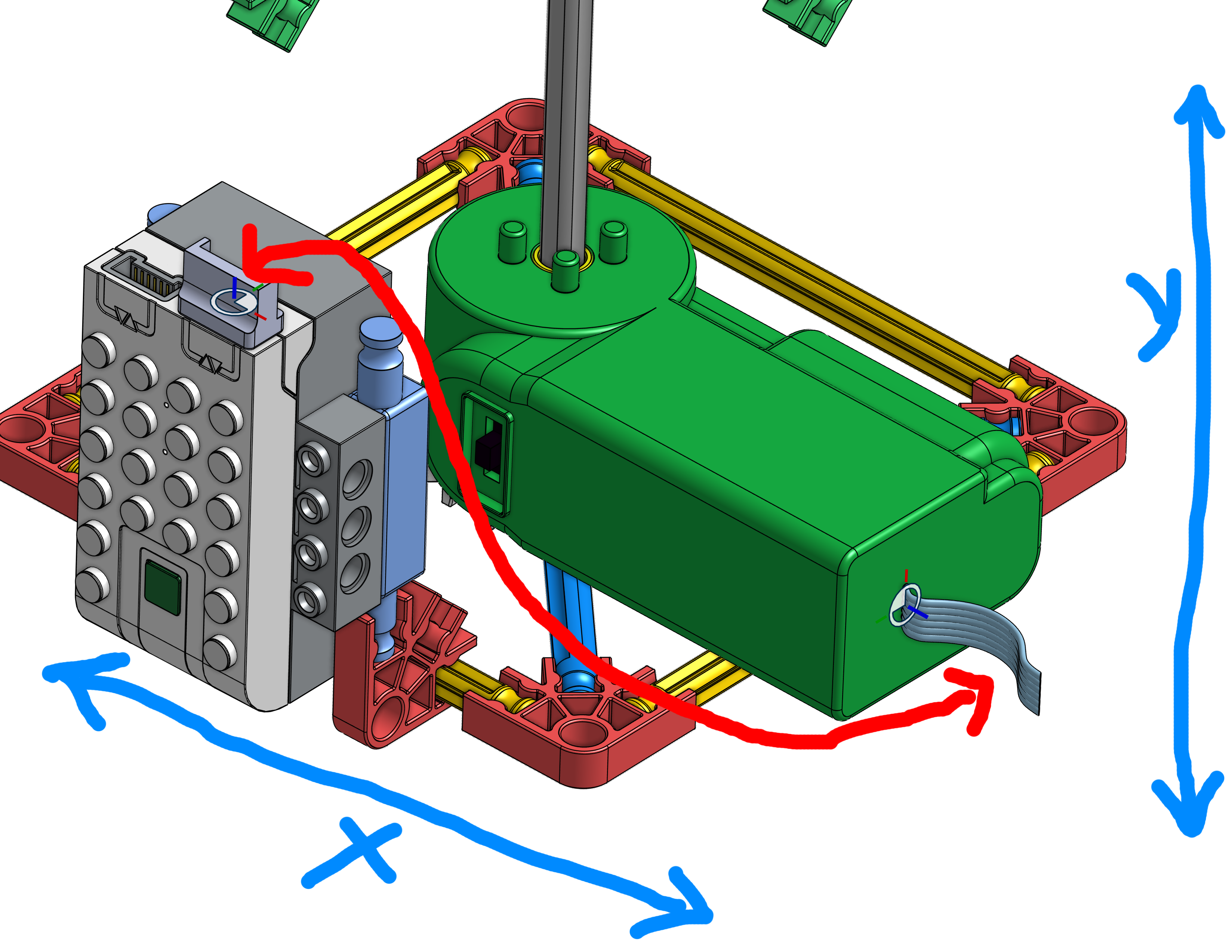

Hello. I want to draw a cable between two parts of a model. What is the best way to do this?
bari
bari Member Posts: 11 EDU
I have two parts of some model which i'm trying to connect by a cable. i tried to do it in the part studio but i can't figure it out right. can anyone help? thank you!
  • GregBrown
    You can use a 3D fit spline feature. You can control start and end directions using surrounding references (planes, edges,faces etc)
    For more control/options there are numerous custom features like the Routing curve….
  • bari
    Hi, thanks
    I tried to make a spline, but I can only do it on the same plane. I'm not sure I did what you suggested: "3d fit spline". I would be very grateful if you could explain to me where the function is...I've been trying for a long time without success.
