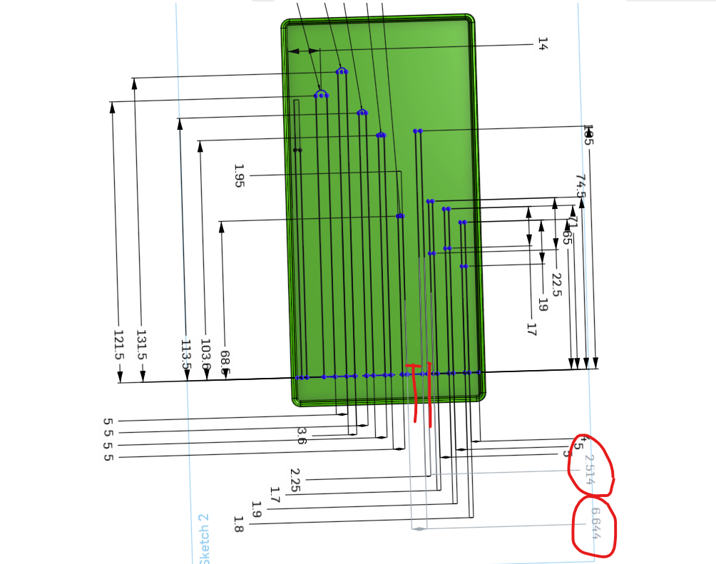

I have been working with Onshape for a while now and can get usually figure out how to do what I need to do. But now I have run up against a problem that I cannot figure out how to resolve besides deleting parts of the design and redesigning. It should be simple but I cannot figure it out. I have designed a Gridfinity container to hold Allen wrenches and the like. I have measurements between the different slots to space things out but there are a few slots that when I use the measure tool to set the distance the measurement shows as a reference measurement (its grey) and if I try to change it things turn red. There are also some of the slots that I cannot add a radius to the bottom, if I try all of the radiuses turn red. I have run into these issues before and have just deleted parts of the drawing and recreated. I have spent entirely too long attempting to figure this out. Now I'd like to figure out what I am doing wrong.
Here is a link to my project: https://cad.onshape.com/documents/aa08ce2604f653730e5c9cf4/w/94ee02143e0cc4f49b4672e2/e/220655e7250577bd9d744eb6
The main issue of not being able to set the dimensions is shown in the sceenshot marked in red. I also left in the reference measurements to make it easier to identify
It doesn't matter which one of those two reference measurements I try to change it still goes red. Let me know if you need additional info, I tried to provide anything you might need. Any advice would be appreciated.

    the 'measurement tool' you use in sketch is actually the dimension tool.
    when the dimension is black, it is making the sketch behave according to it. (called driving)
    when the dimension is grey, it's only a reference/measurement (called driven).
    when it is red, it means it is conflicting with other dimensions and cannot solve.
    usually the other constraits that are in the chain of conflict will also turn red to help figure out where the chain is. (although this is not always easy.)
    since you've determined the width of the slot, and the width of the slot determines the radius of the fillet, you cannot choose the radius of the fillet again. so make those dimensions driven, iso driving and the fillets will work fine.
    since you've set the width of the slots, and there spacing from the right of the tray, as well as all the way from the left, in the middle there's a resulting gap, which is fully determined by those dimensions.
    if you want to change the gap, one of the other dimensions (e.g. the distance of the last one to the end of the tray, will have to be set to driven, or else a conflict will arise.
