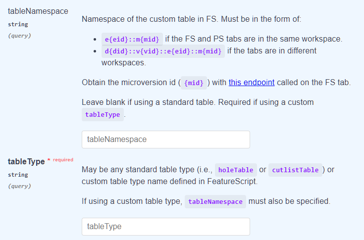

I am consuming the API, and I am interested in knowing if there is a way to query custom tables from a Part Studio.

    What information are you trying to get out of the table? You might be able to get the information without querying the table by using the evaluate featurescript endpoint, or given the fact that your table is entirely made of metadata - just use the metadata endpoint?
    https://cad.onshape.com/glassworks/explorer/#/PartStudio/evalFeatureScript
    https://cad.onshape.com/glassworks/explorer/#/Metadata/getWMVEPMetadata

    I was looking for something similar as well. I ended up having to do other work arounds similar to what Caden suggested with the evalFeatureScript. The only tables that seem to available at this time is hole tables and cutlist table. Hopefully in the future we will see an update to allow custom tables.
    https://cad.onshape.com/glassworks/explorer#/PartStudio/getFeatureScriptTable

    for anyone finding this thread, the endpoint documentation has been updated to include custom tables
