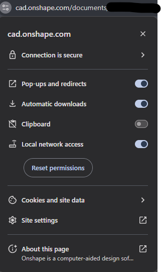

    Here's a tip that might help those who can't get their SpaceMouse to connect. Mine was only acting as a giant, terrible scroll wheel like it does whenever the 3DConnexion server glitches.
    I figured out that Chrome wants you to approve local network access for websites. If you click the little symbol to the left of the address bar and approve that permission, everything works. You'll have to refresh to get it to work.
