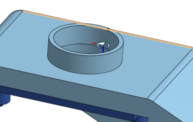

Lofting face hole of camera
steve_wills229steve_wills229 Member Posts: 2
I cannot for the life of me get this to loft as a solid…..Any help would be appreciated.
I can get it to loft as a surface….But not a solid
  • robert_scott_jr_robert_scott_jr_ Member Posts: 767 ✭✭✭
    Hello Steve. I can't grasp what element you selected to create that surface or how you did it so I don't have 'loft' answer. However, just wanted to point out that a simple chamfer would work. - Scotty
    for a chamfer, you'd have to set the offset exactly to the cylinder's height, so a draft may be more robust.
