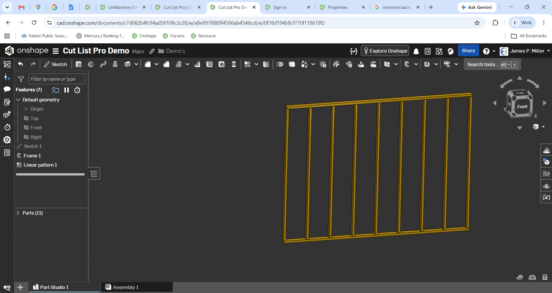

    tim_hunter145 The native cut list tool is pretty cumbersome so I've been working on a feature script for my design needs that might be close to what you're looking for. I'm still working on it but was thinking of putting it up on the www.fs.place site for sale. I added a "WOOD" material for the demo.
