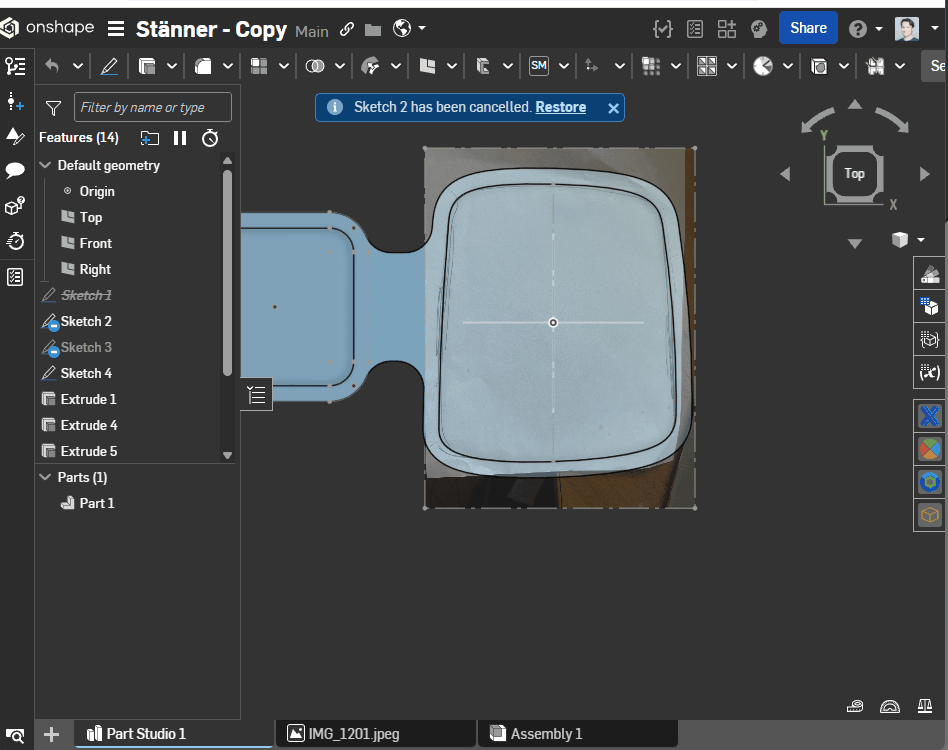

I want to mill a stand for my monitor, I have drawn the shape on a sheet, scanned it and imported it into Onshape.
But it exists there as a separate tab and I don't know how to get the drawing into PartStudio to trace it in Onshape.
How can I do that?

    Create a new sketch on a plane. Then do Insert Image. Once that's in there, you can draw a line along the longest known dimension in your image, and dimension that line, which will scale the whole thing proportionally. Once it's sized and positioned how you want, complete the sketch and make a new sketch in which to trace (i.e. don't trace in the same sketch your image is in)

    I have traced the drawing with Spline and have 2 problems: the size is not correct and the curves are not cleanly traced (the template is not clean either; once I have understood the principle, I will trace the contours again as cleanly as possible).
    How can I scale up the drawing and how can I trace the template cleanly in Onshape?

    The first sketch is literally just the reference picture with one line added to be able to set the dimension. If you have a sketch with no external constraints, the first dimension you add scales the whole sketch:
    Breaking things down in multiple sketches doesn't mean they aren't related, you can still add constraints and dimensions to elements from other sketches.
    You've got some messy overlapping lines at the very top that are causing the issue:
    If you select that tiny region it does work, maybe you selected things differently the next day and included that bit somehow…:
    When working with splines, start with fewer points (basically the ends and one in the middle) and only add points if you can't get the shape you want by manipulating the existing ones. This is easily done by increasing the degree as required. even the way I did it isn't very clean…
