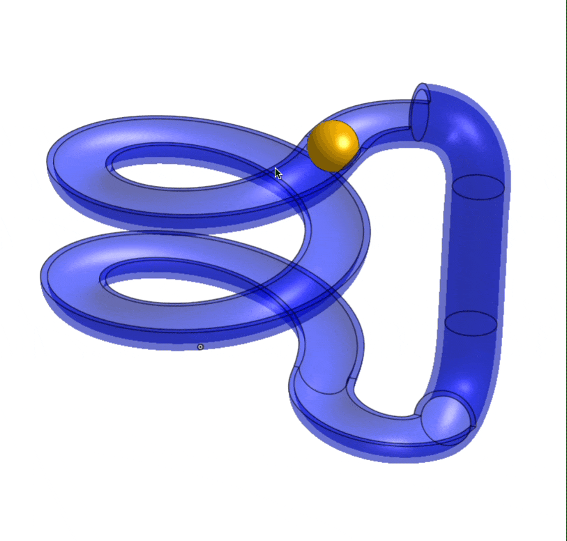

I made a ball rolling down from a spiral slide but how to made the return path up to the top position?
Here is my sketch:

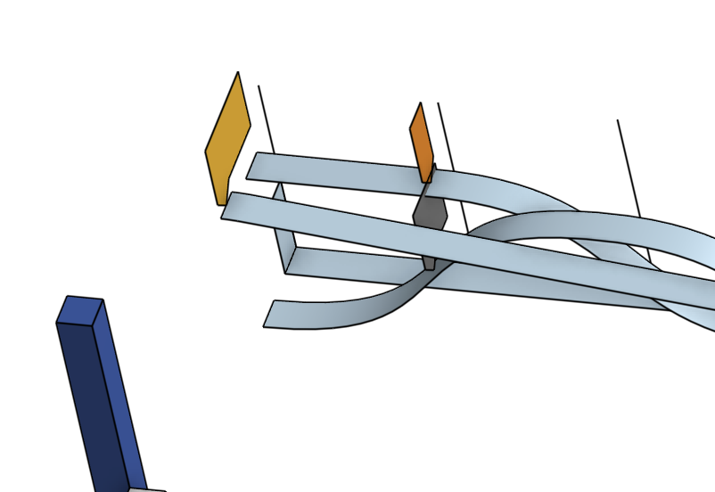

  • EvanReeseEvanReese Member, Mentor Posts: 2,594 PRO
    Aren't all of these tags supposed to be aligned? Seems like some are ahead in the timeline
  • yip_cmyip_cm Member Posts: 26
    Those tags supposed to be aligned, however I found that when I set the 2 time lines at 90 degree out of phase, the shape of the wave form does not match. (see below capture)
    Therefore, I can only keep the same waveform by shifting the tags by 1 duration.
    Are there any better way to solve this?

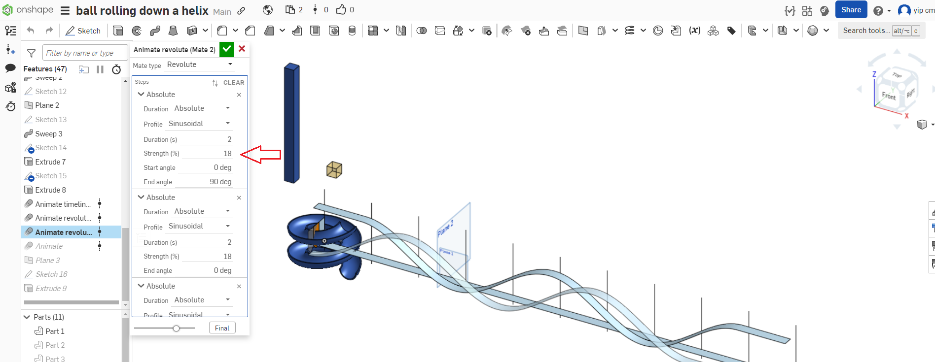

    Just found that there is a "Strength(%)" parameter under Revolute type, after I changed it to 18%, problem solved, {^_^}/
    ( default value = 30%, cannot form a perfect circle! )
    Here is the link:
    https://cad.onshape.com/documents/492d73b26f34b807ac87417e/w/7c113b6061aa7b00048aa1ba/e/6016e8650779cab844d550e2
    My next step is to make the red ball passing through the transparent tubes …..

    @yip_cm … this is not an answer to your animation question, but your idea got me thinking about the overall design. I decided to give a go at modeling this…just for the heck of it.
