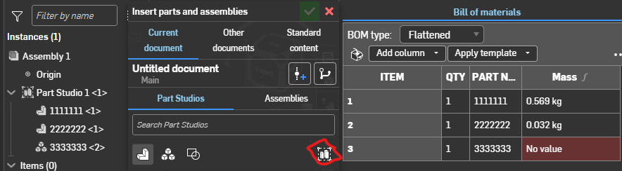

  • tabetha_bulnestabetha_bulnes Member, Developers, HON-TS Posts: 37 PRO
    I am not sure if this is what you are looking for but have tried inserting the weldment as a rigid part studio in the assembly? This will bring in the parts and composite part so that both show in the BOM. And then as long as you do not set a material to the composite part the mass should be correct.
    Below I created a part studio with 2 parts (11111 and 22222) and created a composite part (333333) I then brought in the whole part studio as rigid and then is how my BOM was generated.
