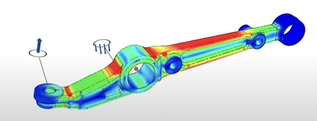

INERTIAL RELIEF
Onshape can now use Inertial relief to simulate free-moving objects in Linear static simulations.
https://onshape.wistia.com/medias/2gnmp5e2c8?embedType=web_component&seo=true&videoWidth=960

  • aeromorrison
    aeromorrison Member Posts: 92 PRO
    I'm excited to try out these improvements. I'm also anxious to do some inertial relief comparisons with other analysis tools.

    It's funny, I went into an old analysis last week which failed for some reason, I couldn't figure out why.
    Oh, someone added an on/off button! I just turned on inertia relief on and it's running again. My assumption was that it was always on. Some of use simulation a lot and like it.
