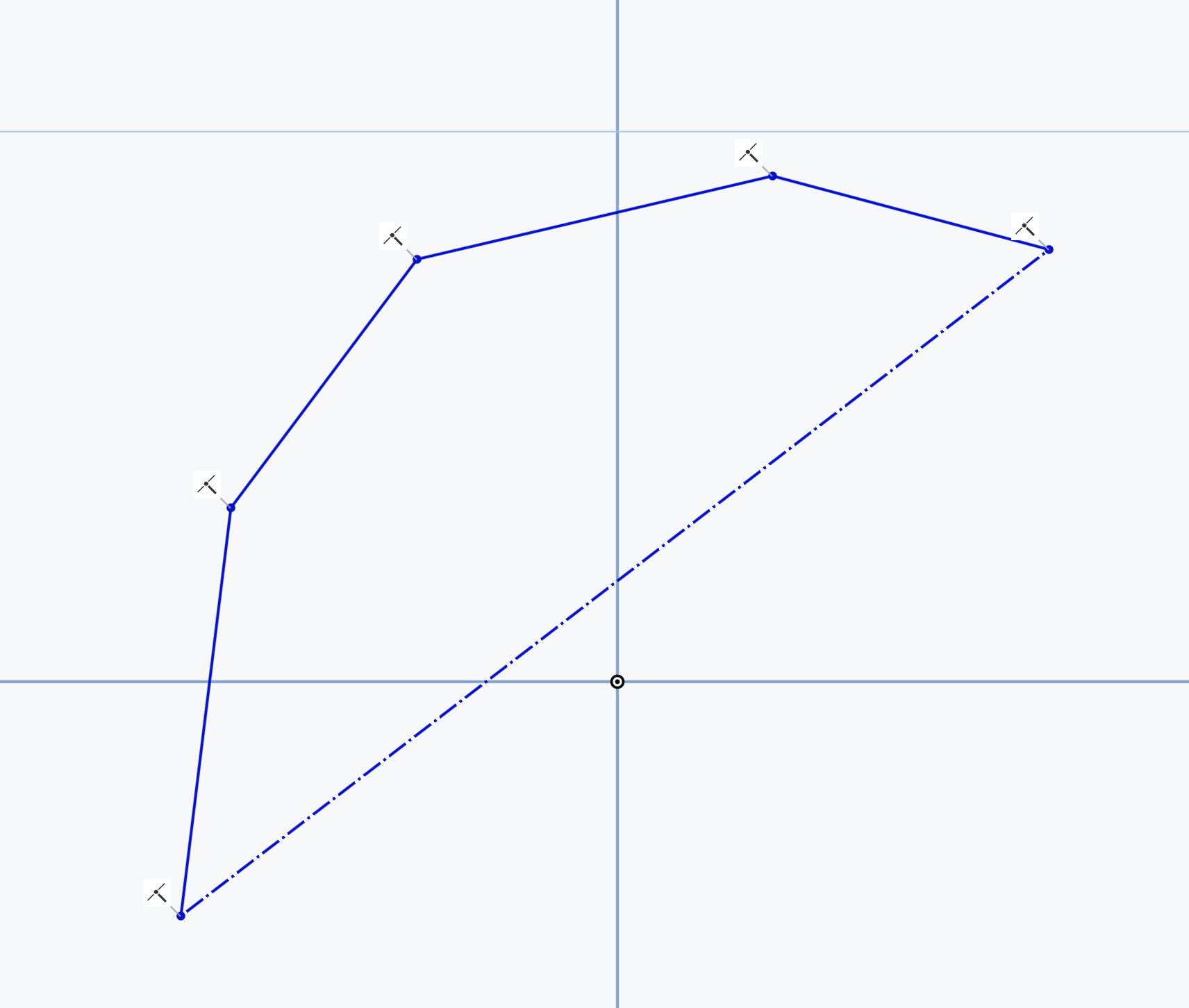

Working through the introductory tutorials of OnShape. One command that does not work on my system is the curve constraint command. Not sure what I am doing wrong but it should be a simple double click to turn two segments into a curve. Do this over and again and two lines remain. Not a huge problem but one day I may want it to work..
Any help would be gratefully appreciated .

    The curve constraint ensures that two curves (e.g. Bézier curves) have the same curvature at the connection point. This constraint does not turn straight lines into curves.

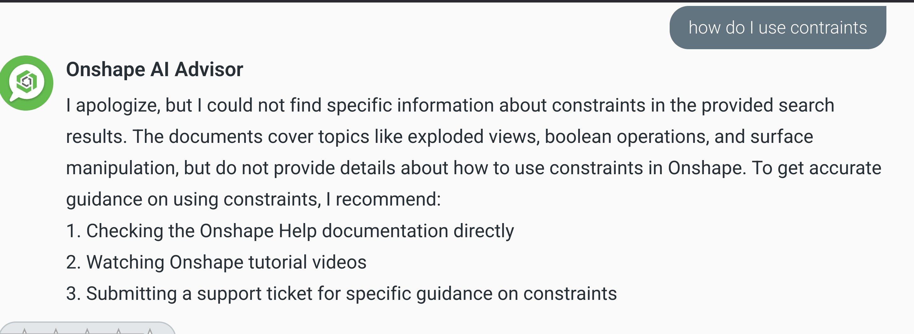

  • MDesign
    @NeilCooke I always misspell that word for some reason. ugh. Grok and chatgpt don't care if I misspell something. 🤣

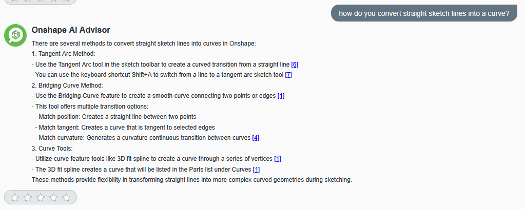

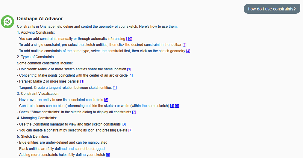

    Here's a revised screenshot with corrected spelling. 🙄
    @peter_marsh559 This link should help you find answers fairly quickly for things like constraints. https://learn.onshape.com/pages/ai-advisor
