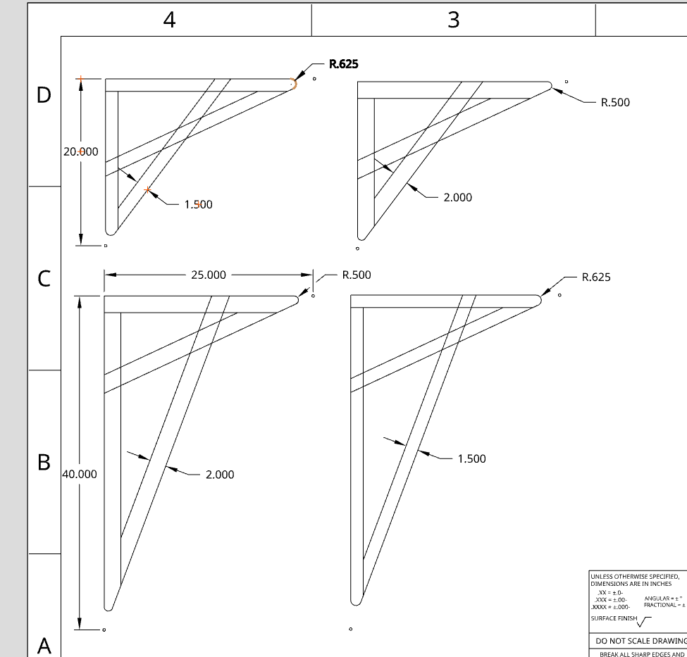

Is there a way to copy with history, when copied sketches update when the original is changed? If I mirror a sketch without moving it after it is created it will update with the original, as soon as you move the copied sketch it no longer updates. Copy and pasted sketches do not update. I don't want to make a bunch of variable driven copies. Is this even possible? Thanks.

  • carl_mcdanielcarl_mcdaniel Member Posts: 7 ✭✭
    These two parts are identical; I only want to define one and have the other one update when I change the original. This is obviously a 3d model, but I want to do the same with a 2d sketch.

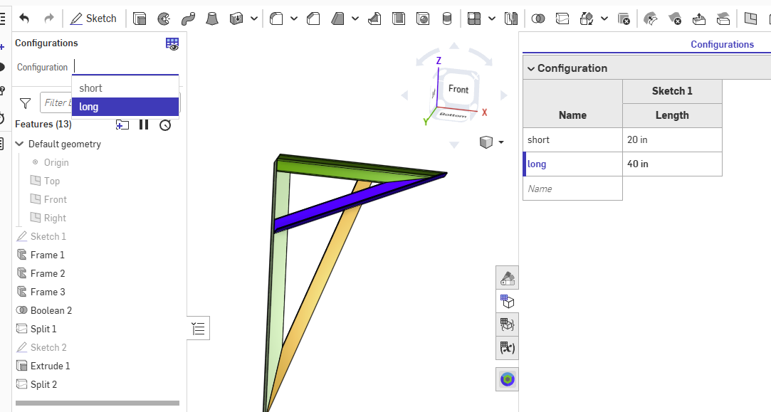

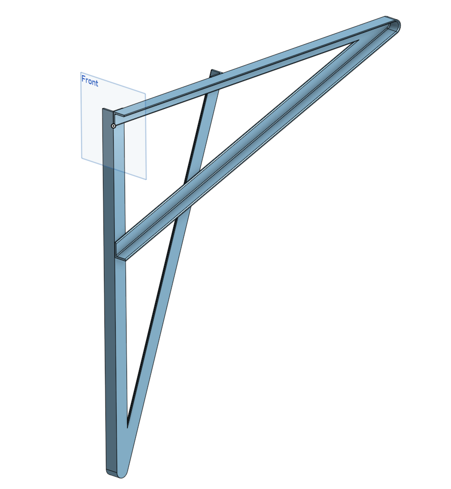

    Multiple sketches take more trouble to manage than configured parts and with more chance of errors. In your case using the same profiles, the the frame tool can give consistant profiles. It's worth the effort to learn OS as a parametric tool instead of fiddling with sketches. Will also provide a visual check of part fits as you go. Attached is a simple sample to give the idea.

    You can do configurations with 2D sketches. no need to futz with copy/paste.
  • MDesignMDesign Member Posts: 1,289 PRO
    Oh I just reread what you are trying to do… Depending on the context of what you ultimately want to do (big pitcture). your sketch for that example would just contain a construction line at 45° from the corner to use as a symmetry line for the symmetry constraints you'd need. Then everything would update based on the modification of one of the sides of the sketch. You could also do it in 2 sketches if you wanted.
