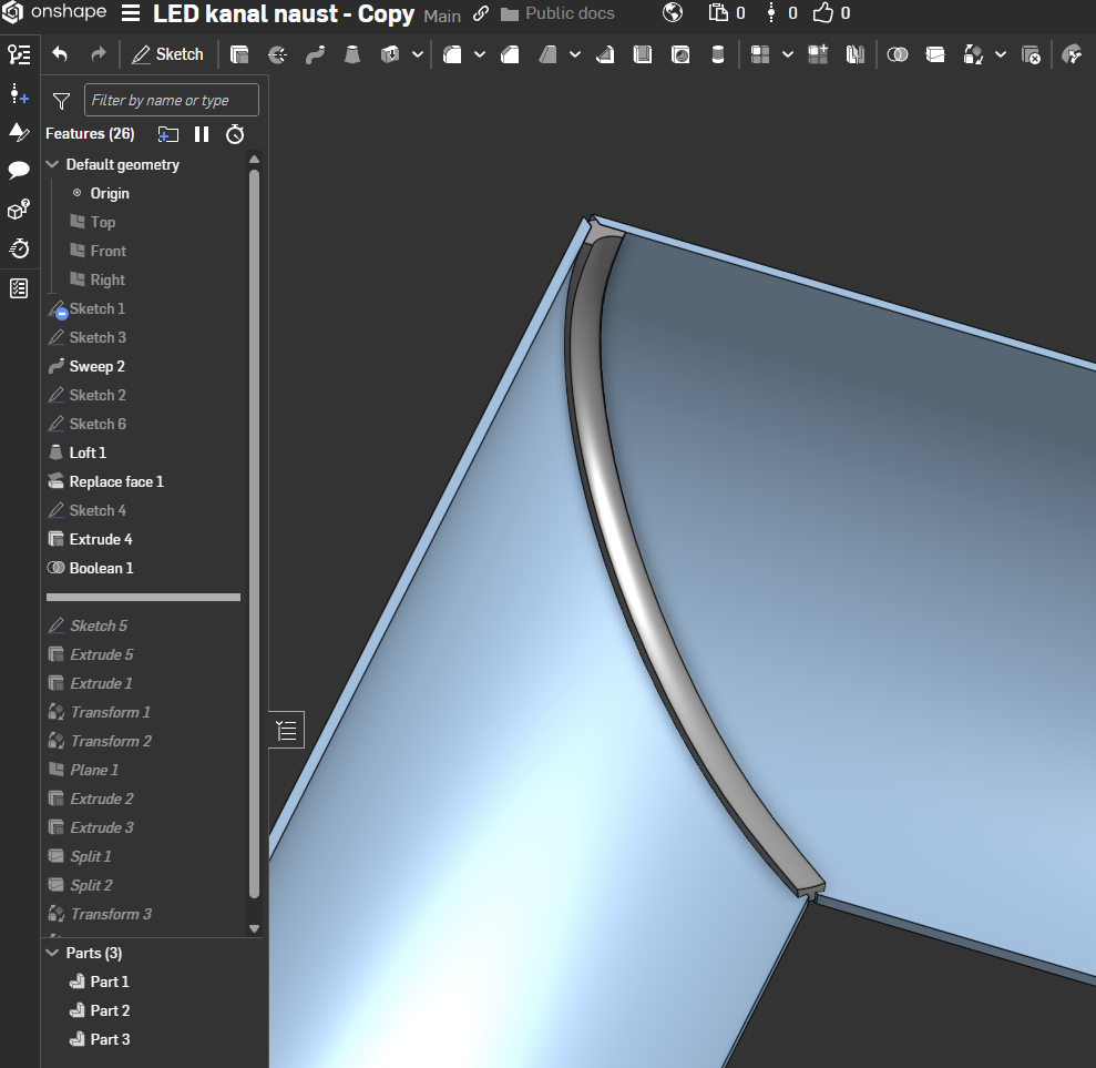

    'not look good' is subjective. what do you want it to look like. I did this with move face, 2 splits and a boolean.
    It is a surprisingly odd shape for sure…
    A loft with guide seems like a better match but it still doesn't really follow perfectly but by making it interfere intentionally and using a boolean to remove the excess it's at least closer, adding a profile in the middle might help.
    This would probably be best done using surfacing techniques (might try again alter if I have time…)
    Note that your really made your life way harder than it should with all the transforms and extrudes:
    https://cad.onshape.com/documents/8ca73998d28734eea0ae3fa6/w/d17681089106c5708023ad69/e/ca5d6075c0ce2a58cff59eab

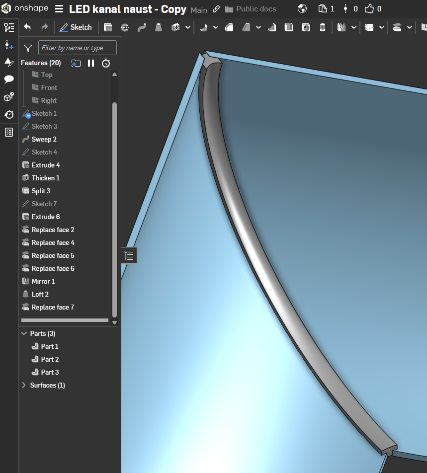

    Gave it another shot to get something nicer looking:
    https://cad.onshape.com/documents/8ca73998d28734eea0ae3fa6/w/d17681089106c5708023ad69/e/88c24cdf964c3dde2f9d3217?renderMode=0&tangentEdgeStyle=1&uiState=68767a12ebf2025809253e4e

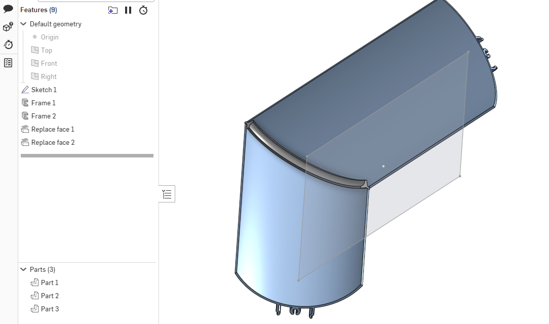

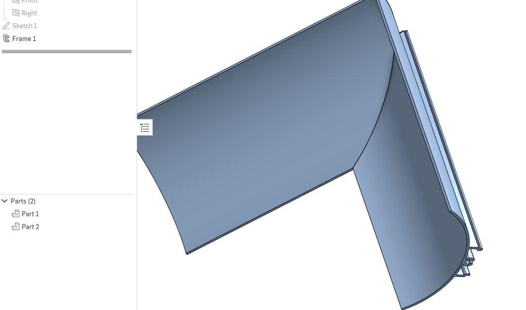

    This version is done with frames tool. Works out well.
    https://cad.onshape.com/documents/22f8d18cc04c0e95e3a13b8b/w/f1f0cc8f2f49f43e38357f77/e/21d276e344b1510e937f0c21
    Oops. The corner piece does not work as a frame since it would have to transition from 90 deg to flat. Cannot be a sweep. Better as a loft if you can figure out how to manufacture.
