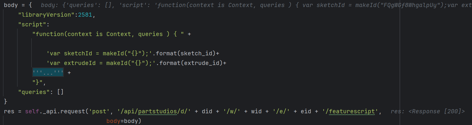

I'm running into a frustrating issue with FeatureScript inserted via the Onshape API (from a Python-based workflow).
Recently, my script started failing with an error saying the qEdgeVertex function is undefined. After some investigation, I found that the root cause seems to be the libraryVersion — it's being set to 1511, which is too old to include qEdgeVertex.
What’s strange is:
  • In the past, I never explicitly set libraryVersion, yet the script worked fine — newer functions like qEdgeVertex were available.
  • Now, even if I manually set libraryVersion to 2581 in the body of the API request, the actual request (or the resulting FeatureStudio document) still shows libraryVersion: 1511.
  • The issue resolves only when I manually edit the FeatureScript in the Onshape UI and bump the library version there.
My questions are:
  1. Has Onshape recently changed how libraryVersion is handled or defaulted via the API?
  2. Why does manually setting libraryVersion in the request body have no effect?
  3. Is there a way to force the correct libraryVersion via the API?
Thanks in advance for any help — I'd really appreciate clarification or suggestions from anyone who’s run into similar behavior.
