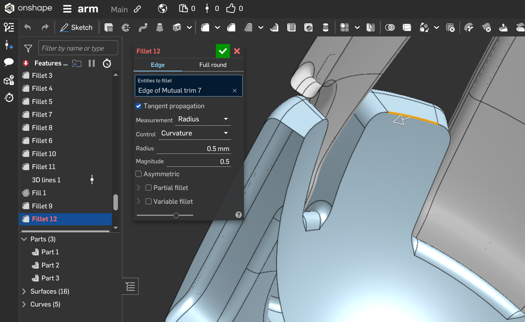

i am having some difficulty applying fillets. it's sort of a general issue in this model and elsewhere, but i'll point out this specific case and see what you can teach me from it. link below, see the k-2so part studio. (bad names, just what was in my head…) for reference, the highlighted edge is 8.5mm and the fillets at each end are 3mm. fillet 12 will generate for a radius of 0.25mm, for example, but not for 0.5mm. my target might be 2.5mm or so, or perhaps asymmetric even. but mostly just not near-zero. :]
i have attempted to do as much of this model as i can with surfacing and continuinuous curvature controls including curvature controlled fillets. i'm sure i have not succeeded at getting it all like that, let alone doing it right.

  • MDesignMDesign Member Posts: 1,256 PRO

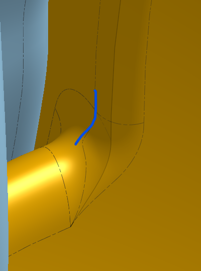

    Once your fillet gets past this blue line runs into a geometry conflict of sorts, it doesn't know what to do once past the top of that ridge. 1.25 is the max.

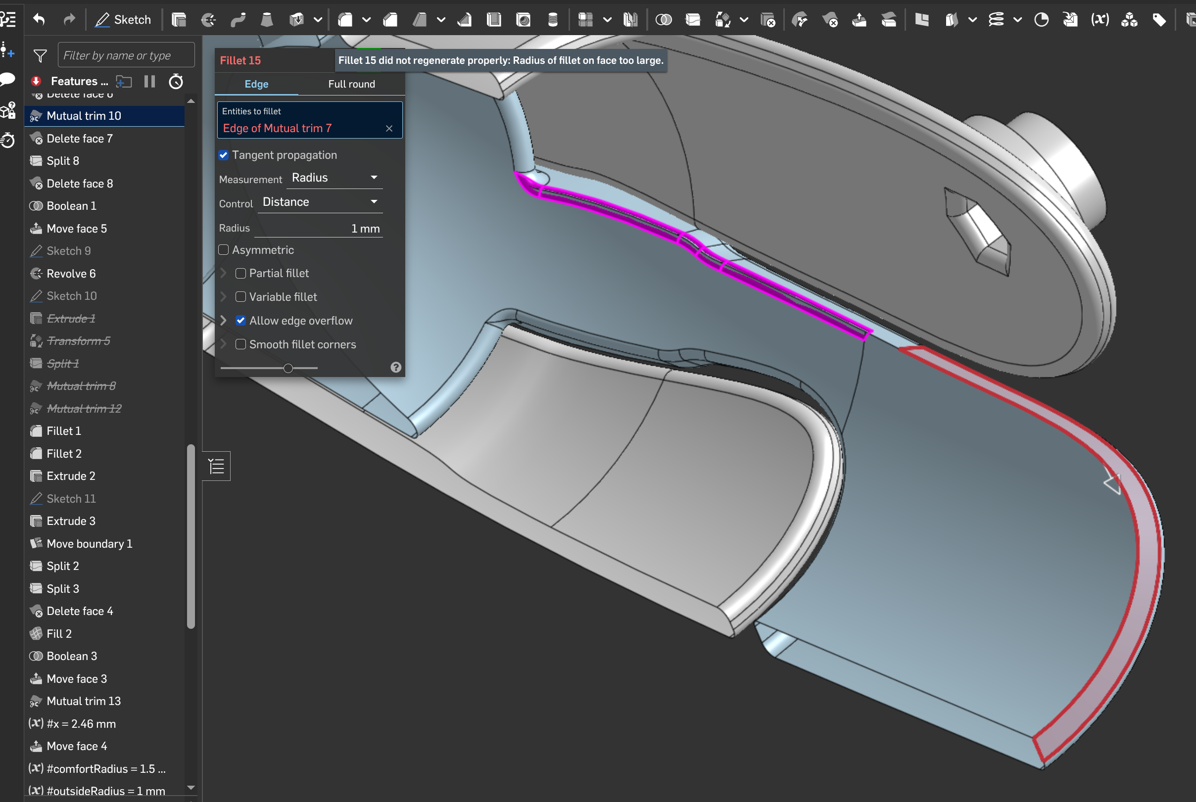

  • jelte_steur_infojelte_steur_info Member Posts: 577 PRO
    For such small radii, I'd recommend a regular radius fillet. using curvature control is definite overkill.
    You'll get highlights and visual lines all over the place anyway due to the fillet so the lack of surface continuity will not be visible. in an injection molded part, let alone a 3d print. reserve Curvature control for major shape defining fillets only.

    ah, hmm. thanks @jelte_steur814, i thought i was being 'good' and making it all better by doing curvature everywhere… thought it might help with transitions and so on. i'll look over the model again with this different perspective. initial attempts show what i think is some improvement in robustness, but not a complete fix (yet). i'll keep trying to understand it better with distance control though.
    i also just tried moving fillet5 later and it ends up that other fillets just end up needing to propagate to those edges. but, i'll keep this in mind as i continue trying to improve this model.

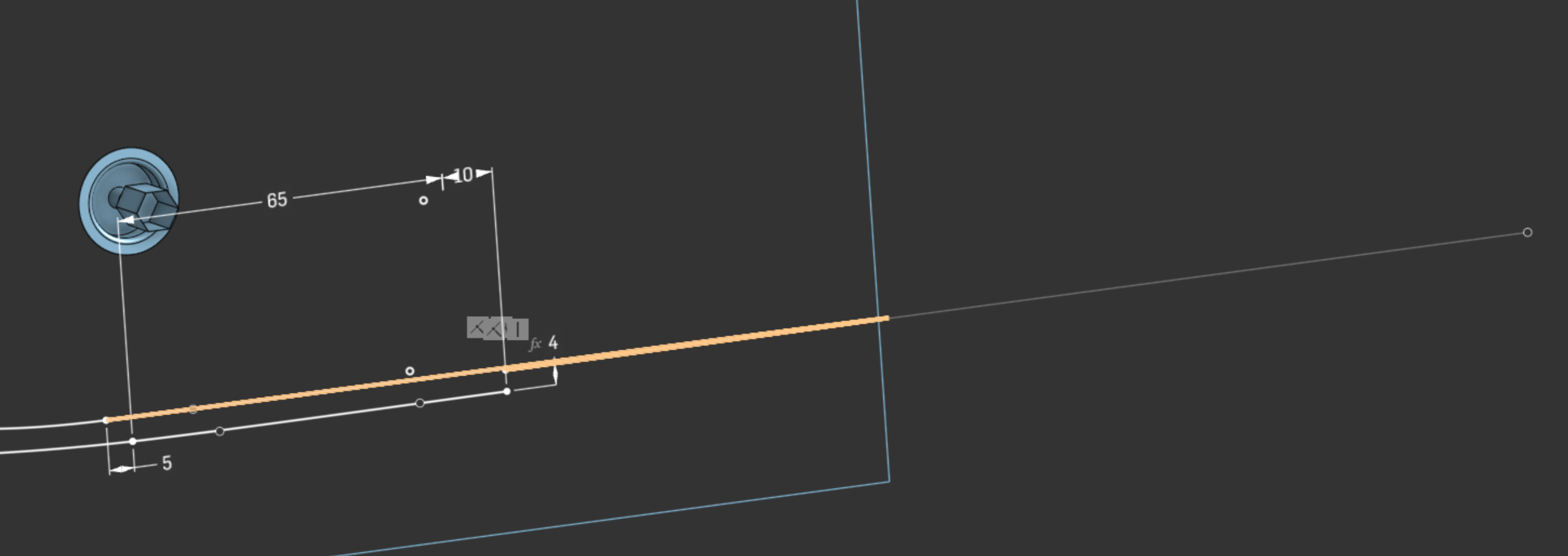

    oh boy… so i noticed that this now single fillet was failing at that boundary on the inner surface. i went back to the definition and found that the curvature constraint of the highlighted spline in the sketch to the pre-existing curve to it's left was resulting in it having to extend way past the point in the middle where it is supposed to terminate. i adjusted a touch there to let it find a not-crazy solution for the sketch and got that fillet working as well. they are all a bit smaller than i want on the inside, but big progress and from @MDesign 's comment i'm going to explore that ultra-acute angle fillet there a bit more to see if i can open up a bit more room for the inner fillet. thanks again, all.
