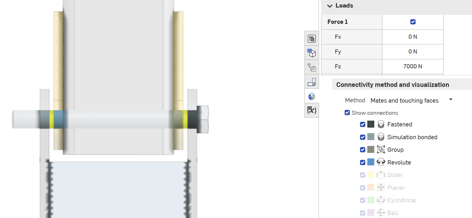

Hi All,
I have two lengths of SHS that I am trying to connect via pivot joint using a M20 bolt and welded on brackets. I am trying to run a simulation of the set up but I can only use the revolute mate on one side of the bracket and when I run the simulation it fixes (bond) the other bracket and bolt together giving a high torsion zone that obviously fails the simulation. I have played around with different setting but can't seem to get it to work I am new to Onshape and would appreciate any suggestions.
Thanks in advance!

  • eric_pestyeric_pesty Member, pcbaevp Posts: 2,542 PRO
    First thought would be to add a cylindrical mate on between the bolt and the other bracket (a revolute is hard to do as tolerances often make it over-defined).
    If that doesn't help, change the "method" to just "mates" instead of "Mates and touching faces" (you may have to add some additional mates depending on how things are otherwise constrained.
  • Dylan_WalkerDylan_Walker Member Posts: 5
    Hi Greg and Eric,
    Thanks for commenting.
    I have tried to use cylindrical mate and use just "mates" for connectivity method. The issue is the other through hole for the bolt to go through doesn't have a mating connection and if i use another cylindrical or revolute connection to define it, it causes an error with the first cylindrical mate. Bonding cause the high torsion zone.
    I think I will just fix everything and treat as a fixed cantilever. Is there an exclude from simulation feature in onshape?
    Thank you for your suggestion and if you have any more please let me know as it is appreciated.
