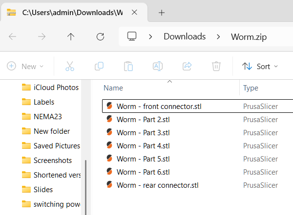

I got a zip file downloaded, and it seems to have only one instance of front connector and one instance of rear connector, in spite of the fact that I have four instances of each in the assembly.

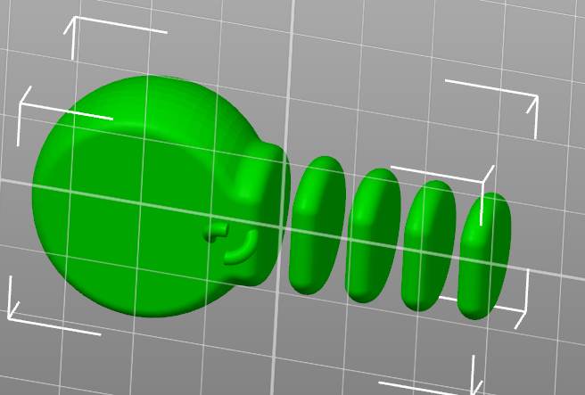

I open these files in Prusa Slicer 2.9.2 (the latest version), and it tells me that it has detected a bunch of parts, and did I want them treated as a single object? I say yes, and get what is shown in the screen shot. Two connectors, apparently in a random place.
So how to I fix all of these problems? The parts all have degrees of freedom in the assembly, even though they are constrained the part studio, I don't get all my connectors, and the only two that show up are randomly placed.

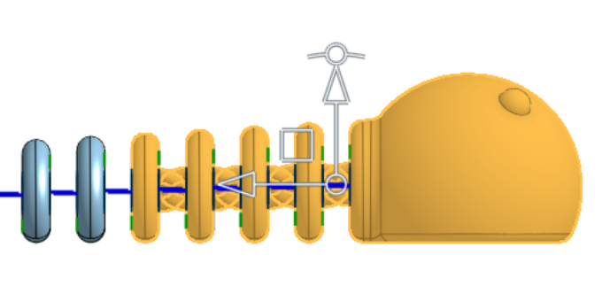

  • Matt_ShieldsMatt_Shields Member, Onshape Employees Posts: 695 EDU
    Can't promise you this will print, but I took a swing at it.
    https://cad.onshape.com/documents/7b265f9547ea96d0c8af0858/w/a086dde488156e48d7b16a86/e/7f7ece659de17780532738f2

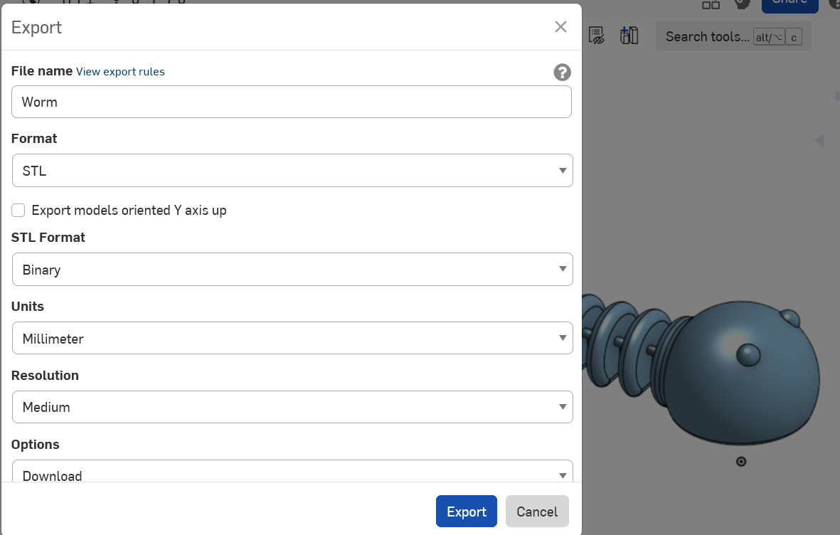

    Turn off export parts as unique parts when you export the STL
  • joseph_newcomerjoseph_newcomer Member Posts: 96 ✭✭✭
    I don't see an option to export parts as unique parts or not
    I also tried by selecting just the parts I wanted to print, right-click export on the selection, or going over to the parts list on the left and doing right-click export. No option for a single STL is presented, although the help documentation clearly shows this option.

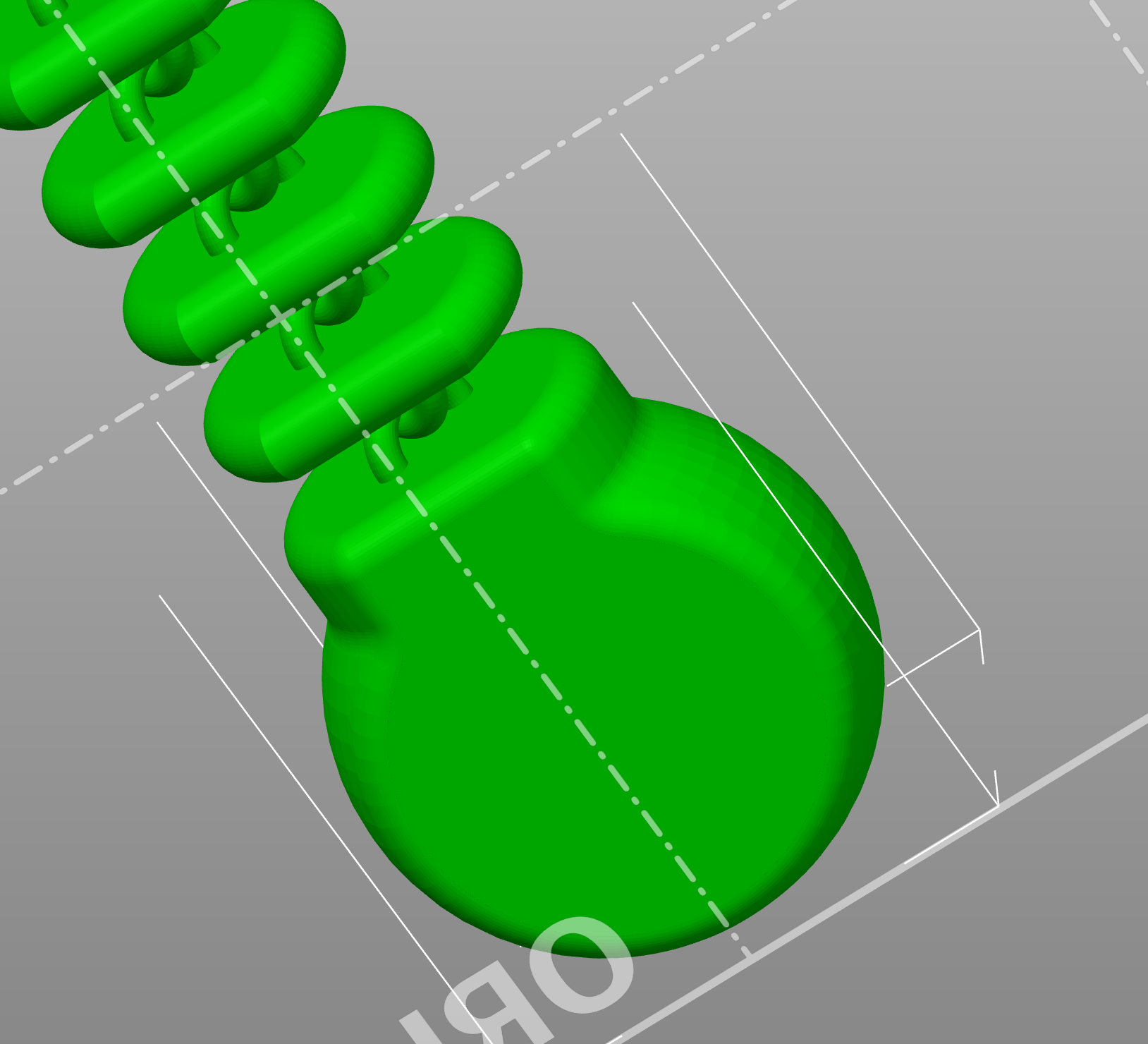

    @Matt_Shields
    It seems to be printing successfully. But I don't understand what you did.
  • MDesignMDesign Member Posts: 999 ✭✭✭
    What device are you on? PC or tablet? It looks like you need to scroll down for more options. But have no scroll bar. I don't remember needing to scroll on PC.
