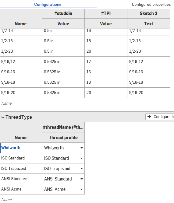

So, you know how you have a materials library, and you can insert a CSV into a document I want to know if I can do that for configurations. So instead of having to manually retype my configuration measurements in. I want to be able to create a way to have this feature and insert it into any project. Is this possible and if so how?

    Yes, but with a painful caveat: You have to create the configuration table, and insert the same number of rows first, THEN, you should be able to copy and paste values into it from a spreadsheet.
    That is how it worked last time I checked, I'm not aware of any improvements yet. ⬇️⬇️
  • MDesignMDesign Member Posts: 1,281 PRO
    @MichaelPascoe You just have to create single junk line then ctrl+v in the first cell.

    Not exactly sure what your asking for but it sounds like you want to import a CSV without defining the configuration tables first. How would onshape know how to associate the incoming data to the model?
