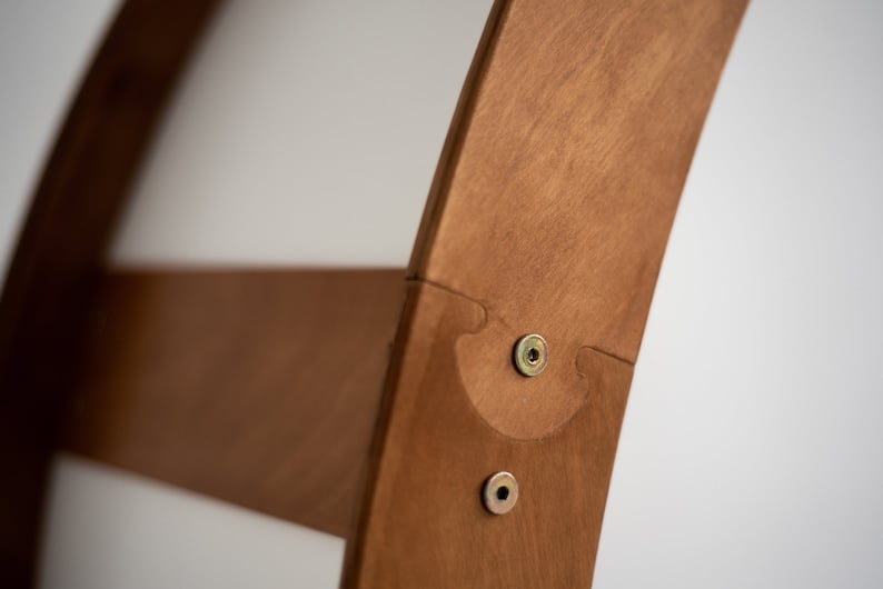

I created a plywood wheel 130 cm external Ø and 120 cm internal Ø, 10mm thickness.
https://cad.onshape.com/documents/24f4b79126f724f3850da688/w/716057b7e5240b984d31cb9d/e/ee7c1a9871fa0931e6dbfb30

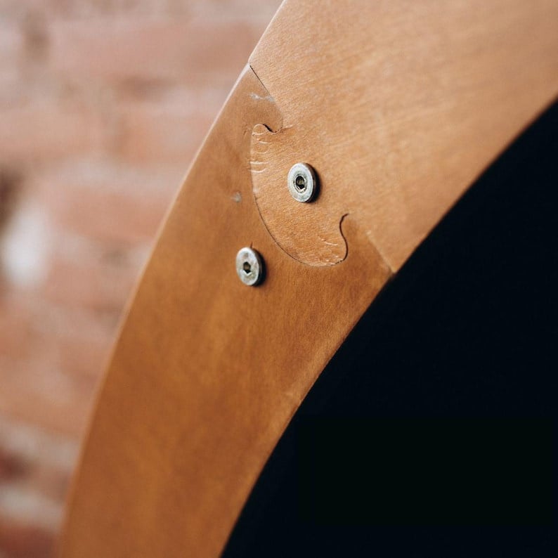

I want split wheel into the 8 pieces and joint it use "puzzle"-type connection, like this:

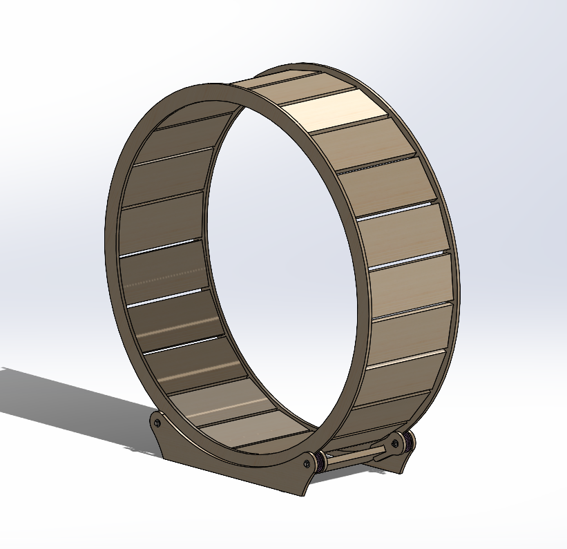

How to create such type of connection? Also, how to add rigidity to an assembled wheel? The finished product should be a wheel with crossbars, like this:
  • MDesignMDesign Member Posts: 946 ✭✭✭
    create a sketch on the face of the wheel with the puzzle squiggly.
    split the wheel using the sketch.
    circular pattern the split.
  • Matt_ShieldsMatt_Shields Member, Onshape Employees Posts: 660 EDU
    Draw the puzzle shape and then use Split.
  • alex_vestasalex_vestas Member Posts: 68
    What tools should I use to draw the wavy curved lines of puzzle?
  • _anton_anton Member, Onshape Employees Posts: 468
    Sketch lines/arcs?
    Yep, sketch lines/arcs.

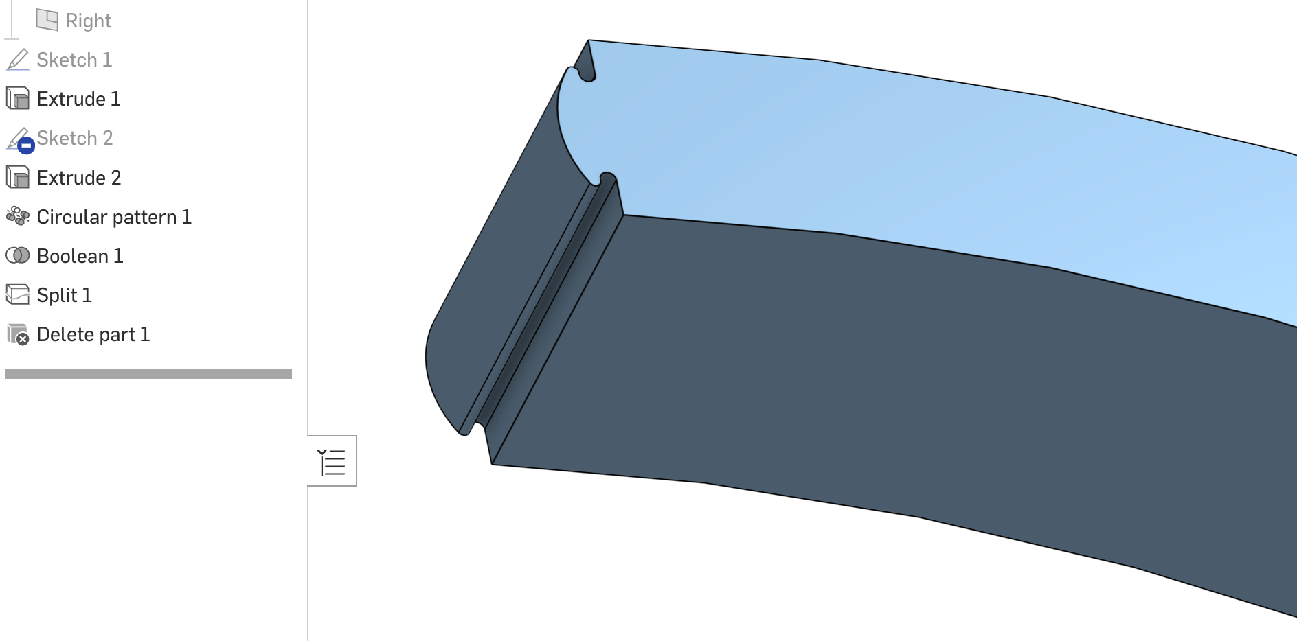

    curves that form the connection
    I should draw on existing Sketch 1, correct? There are 5 different types of arcs in Arc menu. Not sure which one is suitable for particular case. Or I should use ellipse?
