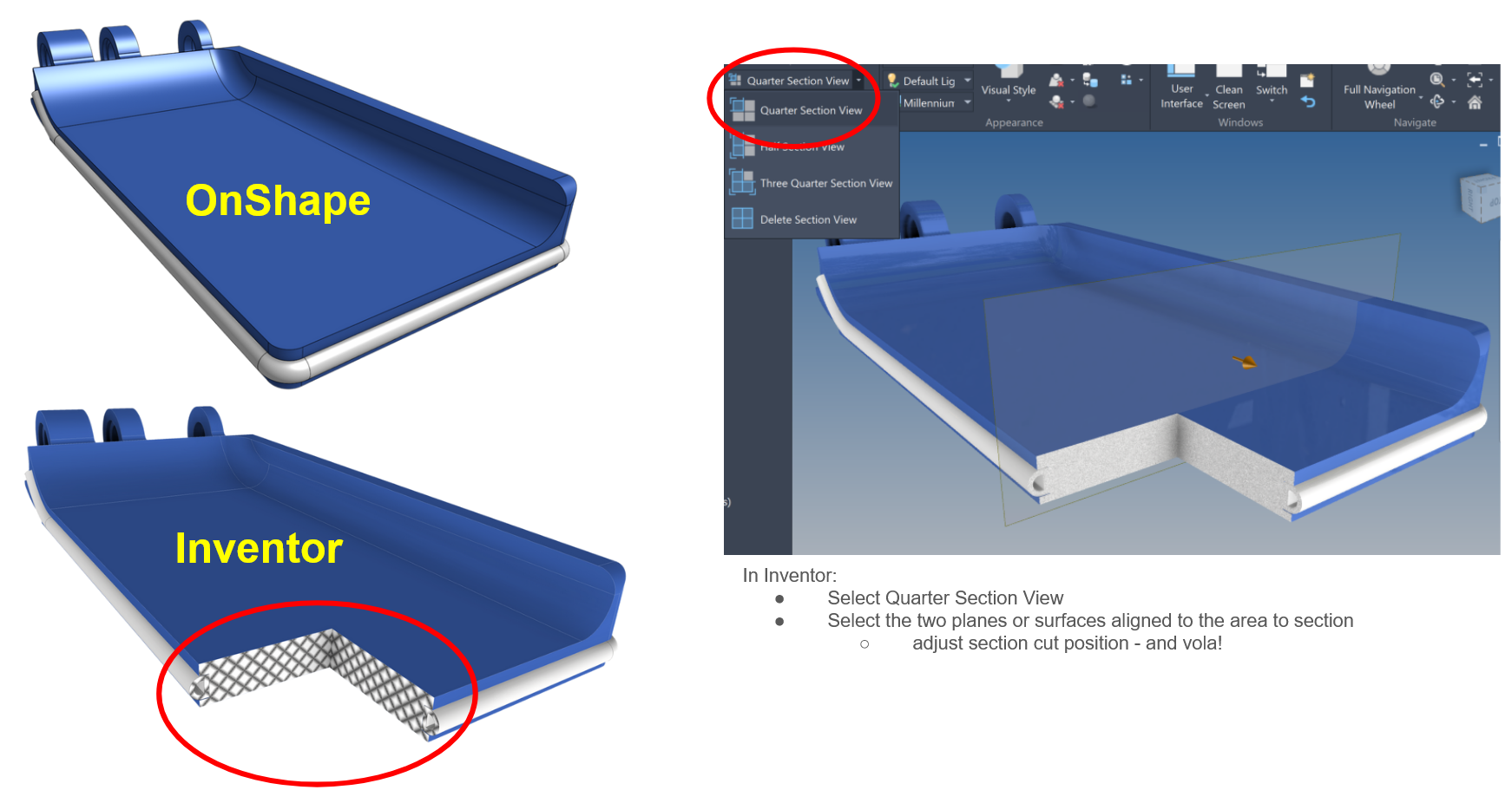

Hi All,  I'm trying to create a Quarter Section view in a Part Studio.
I'm fairly new to OnShape, having spent the last 20+ years using Autodesk Inventor. It's really simple in Inventor, and I'm sure it's in OnShape, but it's not obvious to me. The image below/attached shows what I can do in Inventor that I'm trying to achieve in OnShape.
I've not been able to find the solution via Google or YouTube.
Any help would be greatly appreciated.
  • S1monS1mon Member Posts: 3,982 PRO
    There's no 1/4 section view like that. You can do the inverse with two (or even three) sections at the same time.
