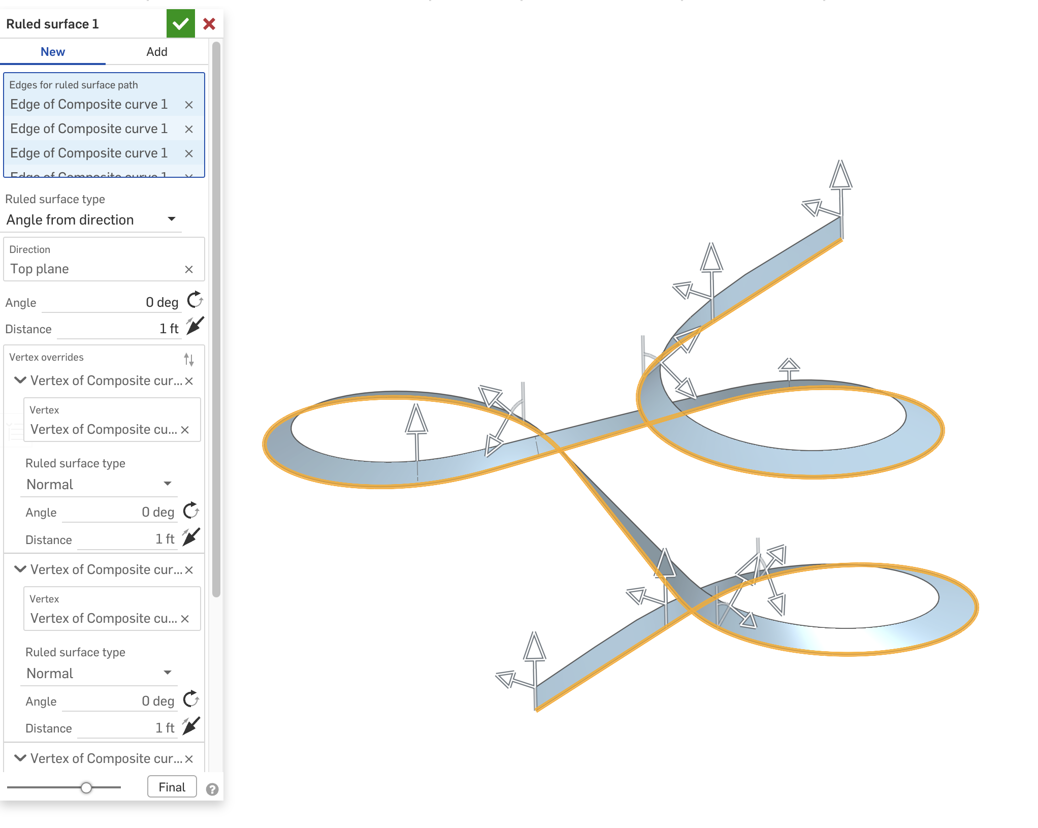

I am working on this project: https://cad.onshape.com/documents/30abfffc6b79032456b95856/w/dc7ae6600856ba71ec521018/e/56d033a41ed824669f9a13b3?renderMode=0&uiState=687cb8cd0d56ff38da5f6c65 and i am trying to create a the rail from the current balltray (part) i have to the big cone in the left, i have tried several methods to create the rail going from end to end, connecting on one side and positioning it well in the left part which keeping the swipped face facing up the all time, i would like to hear your thought for how can i do that.

  • EvanReeseEvanReese Member, Mentor Posts: 2,826 PRO
    If I understand the question, you can use a Ruled Surface to create a reference face so you can control the orientation of the sweep using "Lock profile faces". Here's an example model I made a while back.

  • shlomi_havershlomi_haver Member Posts: 8
    Evan What you suggested looks interesting, however i don't think i understand curves enough, you can check my part studio i have tried to project the path from a parallel plane, then project it to a plane i have created using 3 points, the sweep works but i can't seem to lock it.
    My second try was adding a birding curve which actually looks good,
    I wonder if you can have a look and guide me how to improve it?
