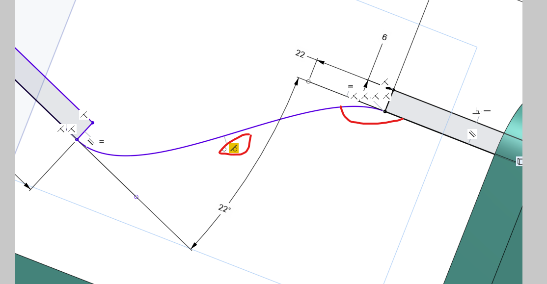

I am following a tutorial on how to build a wobbling disk mechanism.
In the tutorial 2 cylinders are connected to each other by a spline for which the sweet function is used.
In the tutorial the sweeped spline is cleanly connected to the cylinders, but in my case there is a gap between one end of the spline and the cylinder. What do I have to do to close it?
Kind regards
ProApe

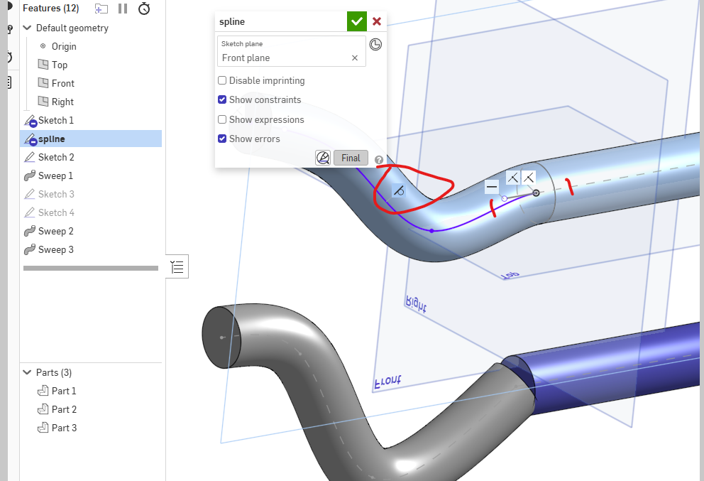

    Looks like the spline isn't normal to the cylinder end. Here's a sample of the difference. Once the spline is normal to the end of the cylinder the model should self correct. In my sample a tangent is used between spline and line.

    If I want to create a tangent relation between the spline and the line, the sketch cannot be resolved.
    What I also don't understand: the side of the spline from which I sweep is always cleanly connected to the cylinder, regardless of whether there is a tangent relation or not, regardless of which side I start on.
    What should I have done differently to get a clean sweep? In your example, you attach the spline to a circle, in the tutorial it is attached to the axis of 2 rectangles around which they are revolved and become cylinders.

    After I changed the spline a little, it worked. I had strictly adhered to the instructions in the tutorial where the barbells of the two splines had to be parallel; they are no longer parallel, but the sweep works!

    I added a second tangent to finish off the spline end so it hits the end normal to. I'm assuming they want you to see some specific tools, other wise the shaft can be done as a single sweep.

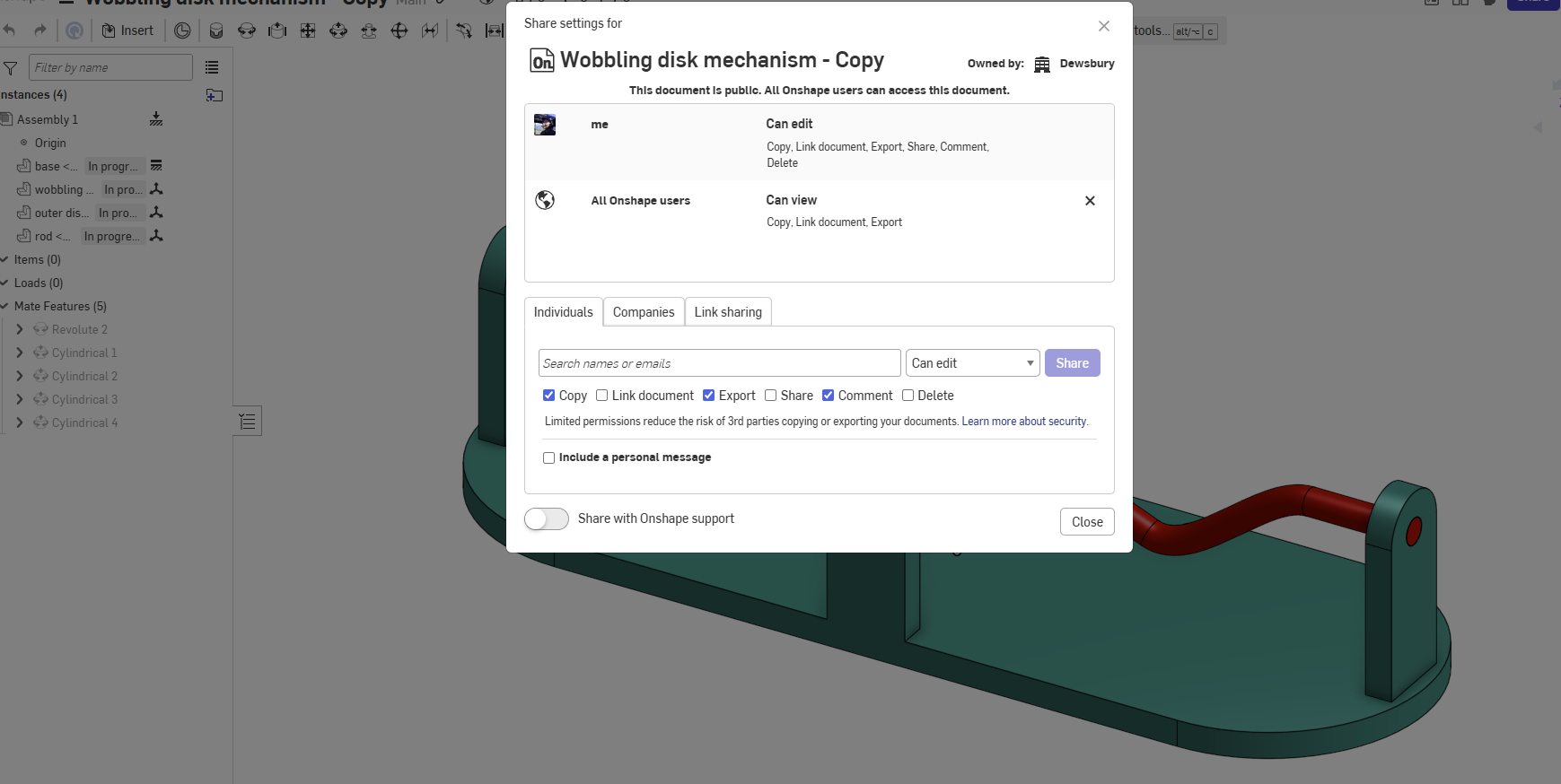

    I may not open the linked document: "Document failed to load for workspace" followed by: "Ressourcen nicht vorhanden oder Sie haben keine Zugangsberechtigung" ("Resources not available or you do not have access authorization")
    I started again from 0, discovered my mistake why the spline was not swept cleanly (the dumbbells must be straight in the extension of the line of rectangles that forms the axis for the revolve of the two rectangles, so as in the above illustration).

    Sry forgot to check public access.
    https://cad.onshape.com/documents/5069cac140286b904b16fae7/w/d840ef46667ce6848f49670f/e/707d546f142f3801f9f17fcb

    With this link I get the same error message.
    edited July 2025
    I you don't succeed try again. If you get the failed to load massage again let me know. There may be an issue at the forum level trying to post links.
  • ProApeProApe Member Posts: 231 ✭✭
    The link works this time.
    Very nice, thank you.
