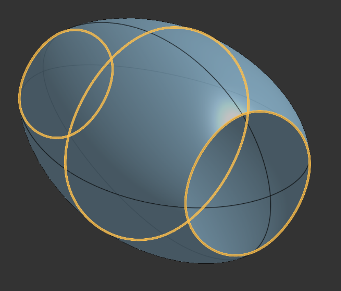

several times i have wanted to make an egg'ish shape, or a plane fuselage, or similar. a revolve is the first thing to reach for, but that can't handle varying profiles in different directions. creating profiles then splines between them and lofting across those comes pretty close. but… from what i've seen all the 'smooth' tools like the various surfacing, splines, and beziers have a tendency to try to have straight lines between the specified boundaries. not literally straight, but even when a spline is routed through four points in a square it will have higher curvature near the points and lower curvature halfway to the next point. i'm interested in creating lines and surfaces that rather minimize curvature variation. when routed through the corners of a square it would create a circle, but when routed through non-regular points it would still provide continuous curvature.

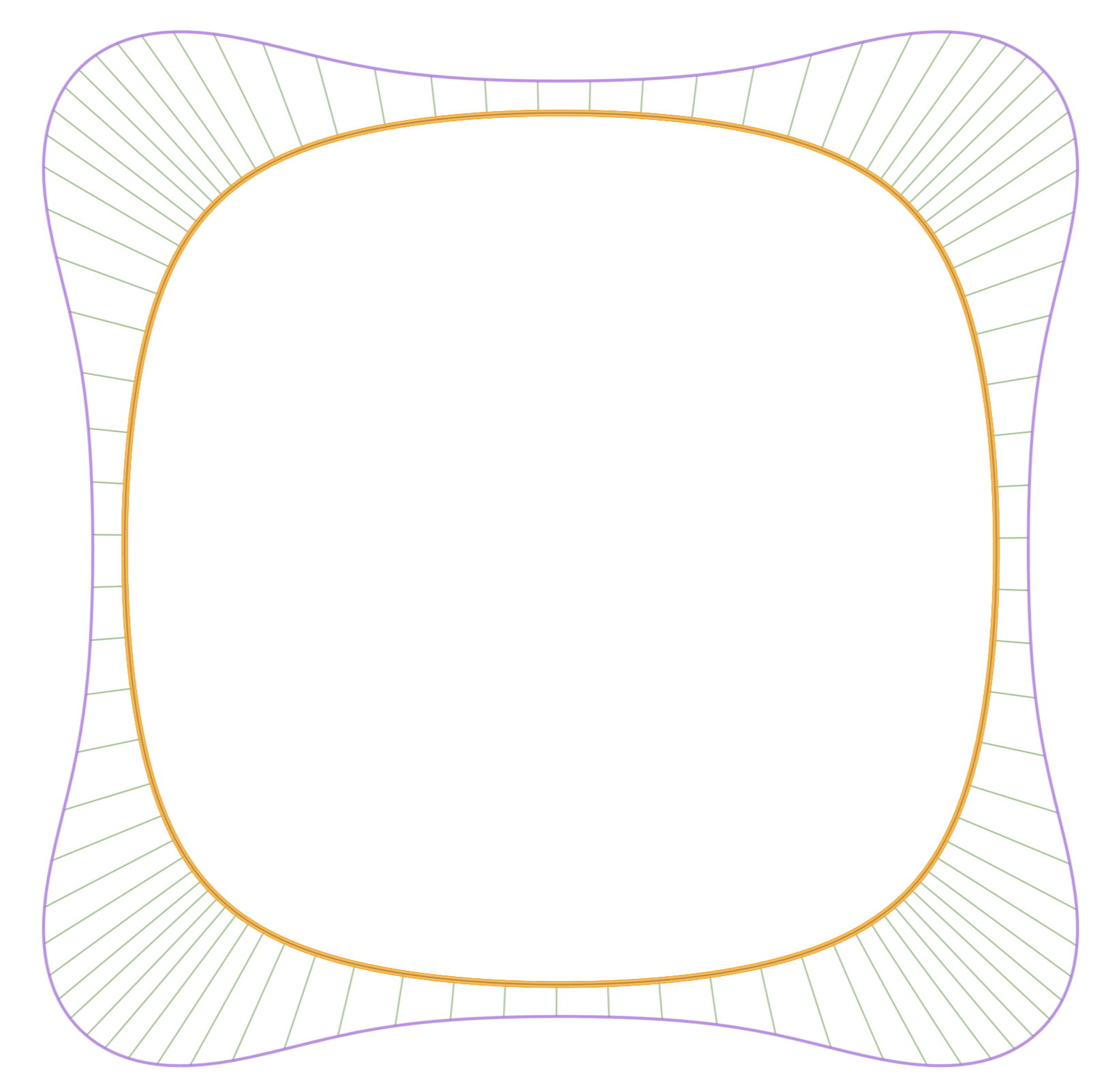

in the screenshot there's a circle on the inside, then a spline in the middle, and a bezier on the outside. yes, the squares are different sizes but it still shows the lack of circularity with the spline and bezier each having a lower radius midway between the points.

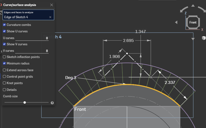

here's an example where i sketched the black curves and would like to be able to tweak each for different applications where some cases may be symmetric and others asymmetric. if they are consistent i would like it to settle the surface to be as if it was a revolve yet still allow for the asymmetric cases to smoothly diverge from circularity.

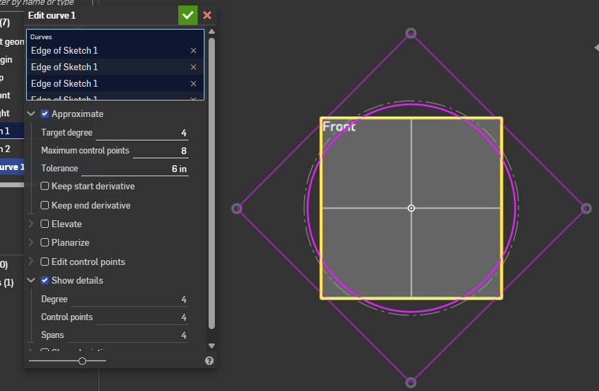

  • eric_pestyeric_pesty Member, pcbaevp Posts: 2,609 PRO
    I tried using the edit curve to approximate a square with a very large tolerance and I did get a circle:

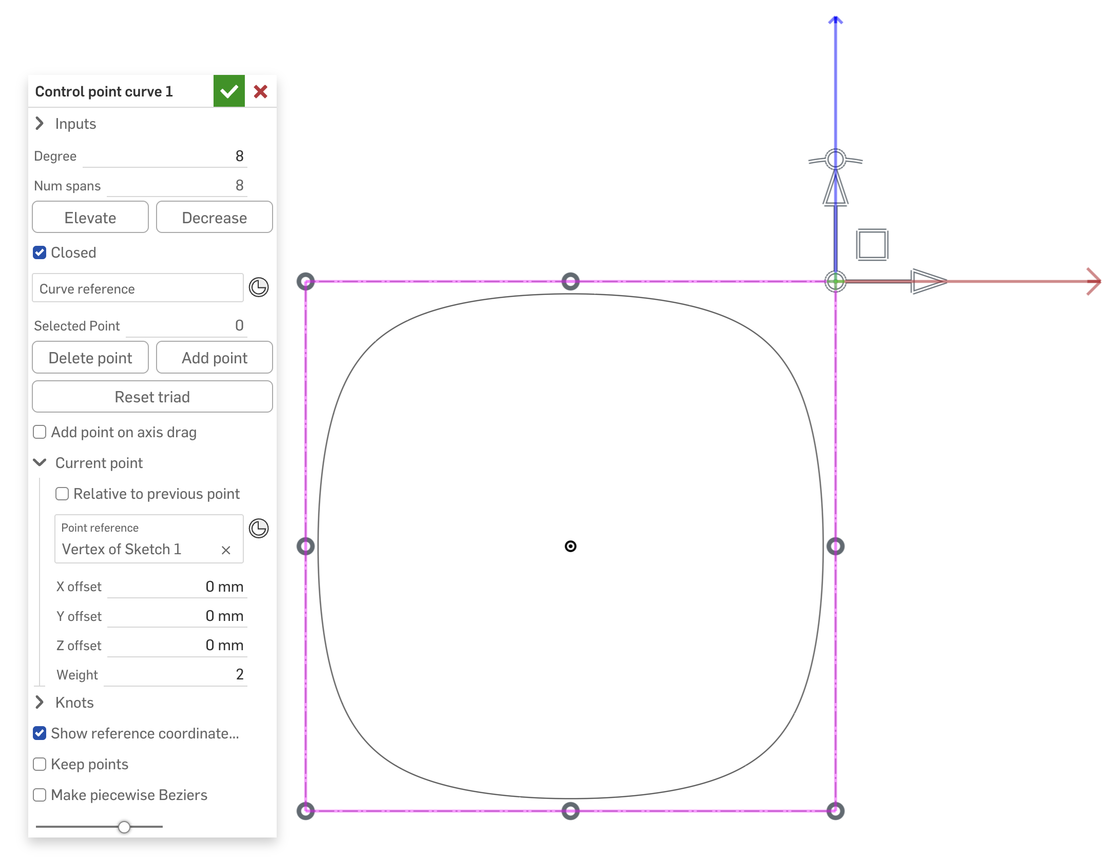

    A good way to do this is with a proper NURBS curve, which you can make with the Control point curve custom feature.
    This document has two examples. In each case the Weight of a particular control point is adjusted to be something other than 1 (thereby making it rational.) The effect it has on the curve is obvious, it "attracts" the curve towards it, and increases the curvature value. You can use it to approximate a circle, or tend towards a square, or something in-between.
    In the first Part studio Periodic (closed)I have used a single degree 8 Control point spline (NURBS curve) and the corner Control points all have weighting of 2.
    The curvature combs are pristine for this…

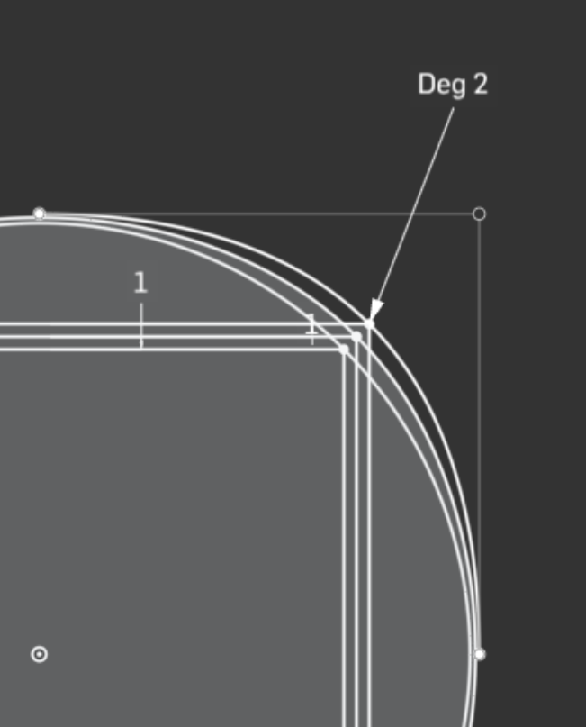

    There is another part studio with one corner created from a Control point spline (degree 2, with the middle CP set to weighting of 2). This is then mirrored twice.
    In both cases just play with the Weight parameter to get the desired effect.
