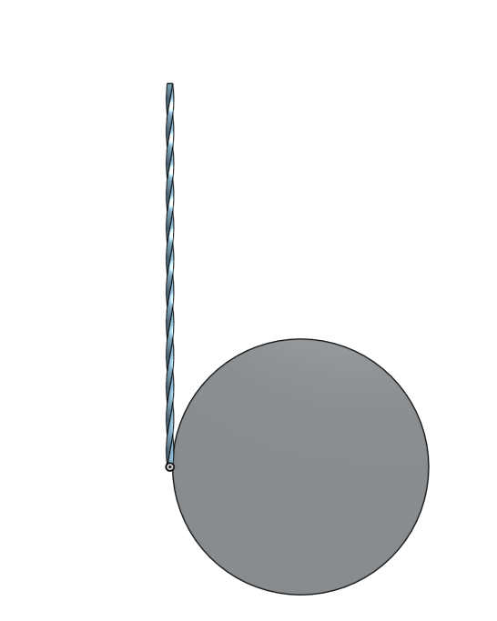

I'm trying to bend this thingy around a curve, is that possible?
Like bending the stick thing around the circle?
  • MDesignMDesign Member Posts: 960 ✭✭✭
    you can’t bend things. You have to model them bent
  • EvanReeseEvanReese Member, Mentor Posts: 2,468 ✭✭✭✭✭
    I would love for Onshape to add tools to taper, flex, and otherwise distort geometry like this.
  • Derek_Van_Allen_BDDerek_Van_Allen_BD Member Posts: 141 PRO
    edited July 31
    I have been working on geometry distortion tools, but alas there's a WoW patch dropping next week so development has really slowed down.
    hahaha I am excited to see what you come up with. I do think there's a lot more power for deformations available with Parasolid, but not exposed yet to FeatureScript.
