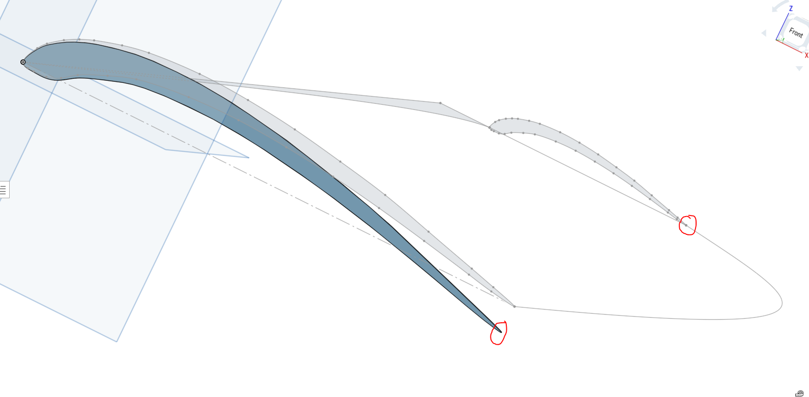

How could I join these two points to then use it as a guide for loft?
nikodem_sanecki
Member Posts: 2 ✭
After I rotated the base airfoil it didnt let me complete the loft as the guides did not touch one of the faces I was trying to loft. Is there any way of doing this? or should I stay with the base airfoil having no angle of attack?
https://cad.onshape.com/documents/27a2536ac3caf7e9355544df/w/0e4a4dd23b0fc49f5647ddc4/e/03178bf25487f657f4bc5650?renderMode=0&uiState=688aaa27eeca364376987637

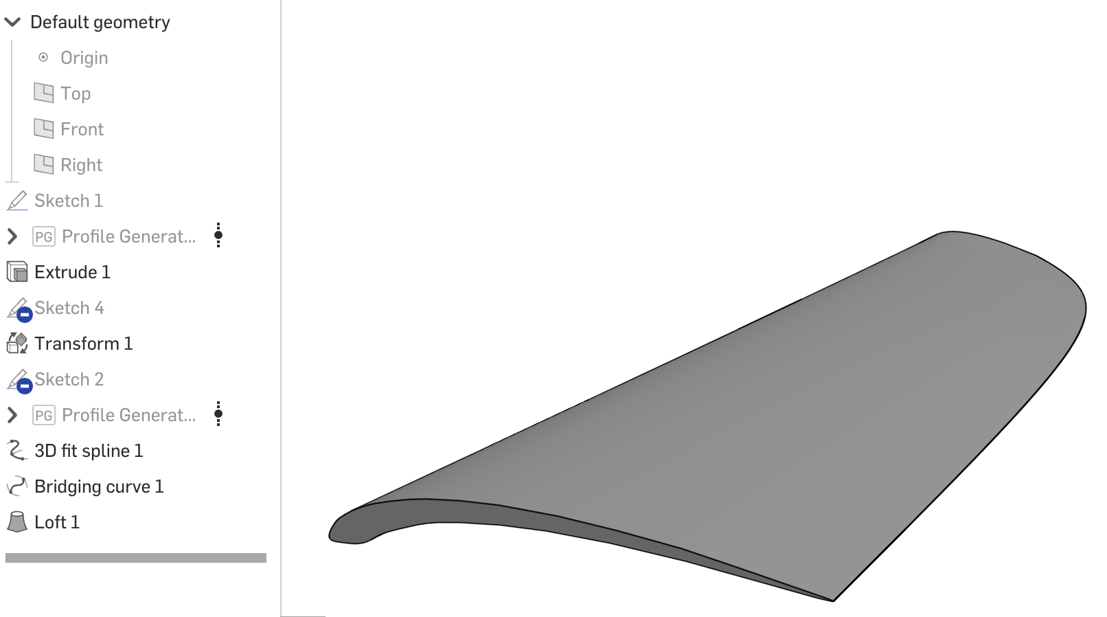

I used 2 guides, a bridging curve and a 3D fit spline.
https://cad.onshape.com/documents/9b5773e3a33822194299ad09/w/15a0e05955df3d1be668fbce/e/0f6d42ebdd1e95beeb75edeb
