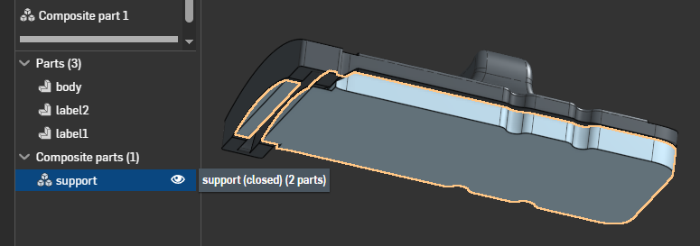

I must be missing here something, but when I have a closed composite part (it listed as one part)
and then export entire part studio with Export unique parts as individual files enabled, it breaks the composite part into separate parts and naming them as Surfacenn(where nn is a number)
First of all, they are solid bodies, not surfaces, but most importantly, I'd expect it export the same number of objects as per parts list, aka leaving composite part as a single part.
