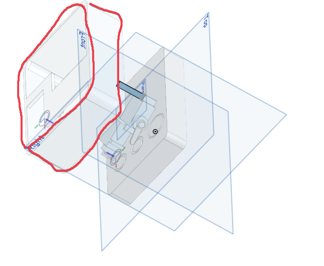

I am drawing a box for my intercom. This goes like this
intercom (for reference) ———>

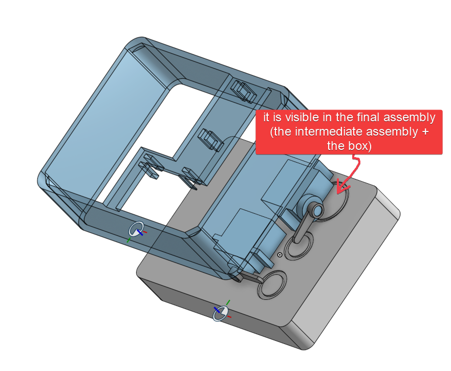

assembly of both (still for reference) —— > new part (the box), in context
servo motors (for reference) —->

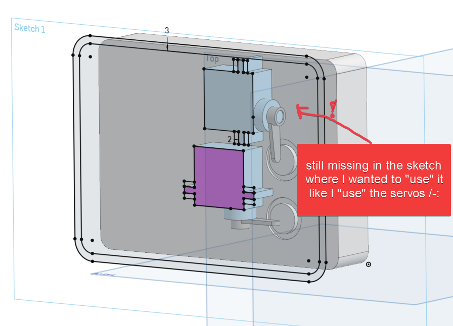

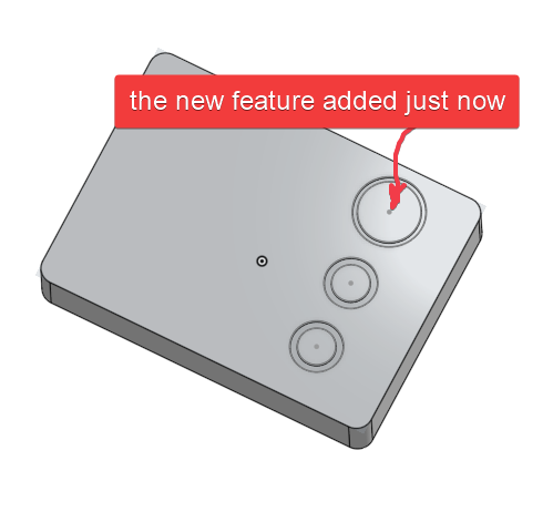

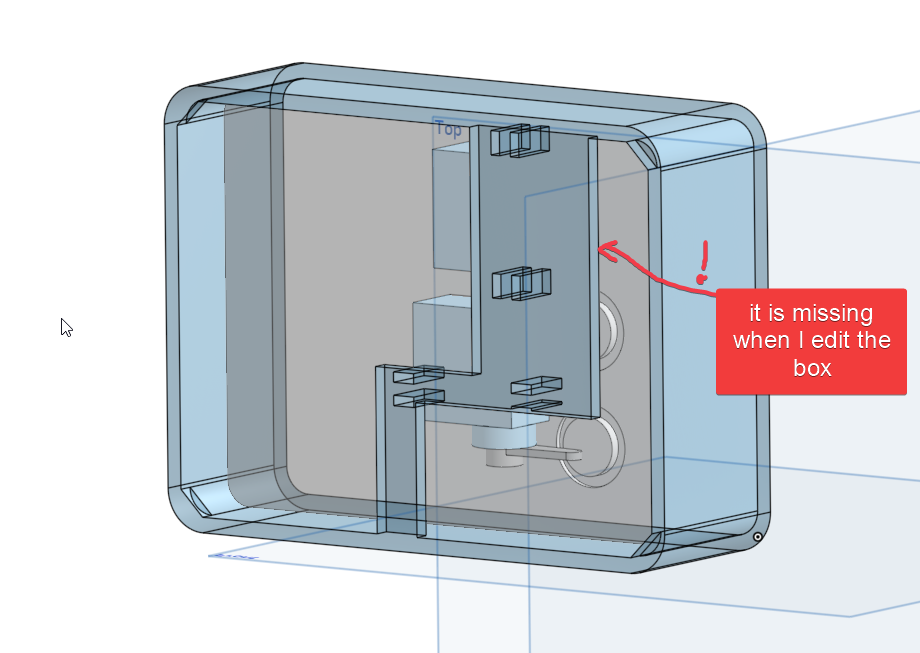

I then modified the intercom to add an extra feature but it is not refected in the box:
I tried to move between the tabs, close the browser, refresh, pray - the new feature does not want to appear in the box Part Studio
—-EDIT: It is seven worse: I deleted the piece highlighted in red, but it is still there (as a ghost, not referenced anywhere)And I do not see a "rebuild all" button anywhere so I am a bit stuck

You need to enable "Copy" on the share permissions of your public document if you want people to really take a look. But, it looks like you need to update your context.
https://cad.onshape.com/help/Content/in-context.htm
https://learn.onshape.com/courses/managed-in-context-design
Thank you @Matt_Shields , that was it. I am still struggling to understand what the context is (I read the link you provided and watched a few youtube videos) - not the concept, but the relationships between the elements. This is something I will investigate further.
