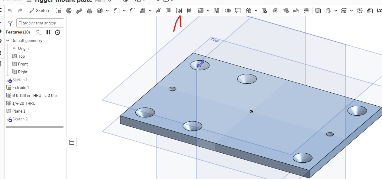

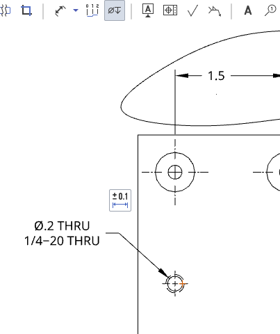

ello everyone! I have a problem - I can't make a callout for the size of the hole diameter. The Hole/thread callout button does not work.k.
    edited August 2025
    Question. Did you use an extruded circle for the hole or the "hole tool"?
    The hole call out in drafting responds better when the hole tool is used in part studio.
  • I used a circle to extrude the hole. I always did this and everything looked fine on the drawing.
  • martin_kopplowmartin_kopplow Member Posts: 1,217 PRO
    Could it be your (extruded) hole is not perpendicular to the view? In these cases, or if the surface around the (extruded) hole is not planar, the callout might not work.
