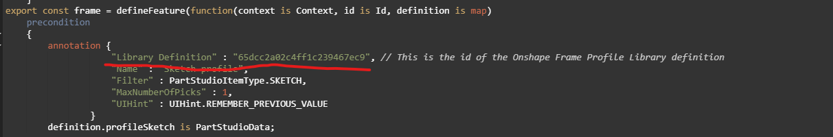

    @Derek_Van_Allen_BD Can you not just copy the Forms feature then instead of making forms you make the parts you want, then insert them similarly? That's kind of like what I did with the Imprint feature, it uses the frame profile library as it's backbone for a user defined sketch profile library.

    Kinda but that's not quite enough. Using form studios gets me the configurable seed geometry instances the way I'd like and I can make my own "laser kerf tools" library, but the thing I'm looking for is a way to bake the library definition ID into the feature so that whatever library I develop is kept loaded into the feature for others to use without needing to go digging for studios or rebuilding my library for themselves on their end. Currently I don't think it's possible to share frame or form libraries with other users and even if it was it makes it less likely for people to use the feature if they have two things to manage.
