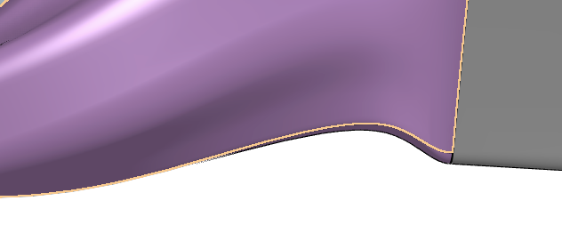

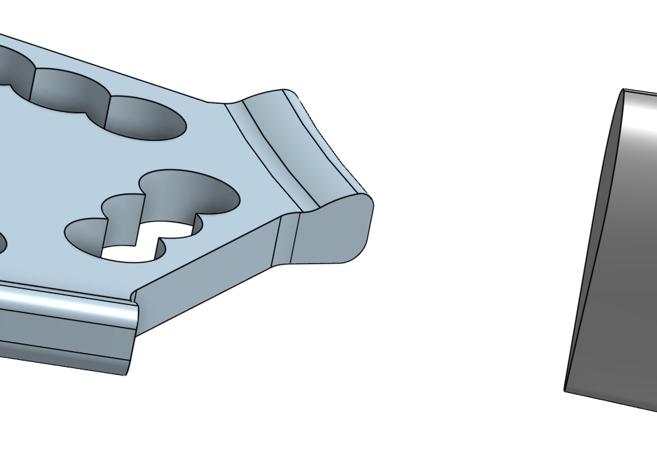

I have a loft which is confounding me. I have a loft feature where it's very easy to imagine filling in the concave voids with putty, and filing down the wrinkles.
No matter what I do, everything makes the wrinkles worse. I tried no constraints all the way to lots of tangent/curvature constraints and while I can see some improvements nothing solves the problem for all sides. Everything I do seems to add some level of goofiness. And yet it feels like it's always easy to visualize how the strangeness would go away:
How should I think I think about smoothly connecting the two pieces with a loft? Is there a command to tell the loft that there should be no concavities, and/or no path radii below a certain amount?

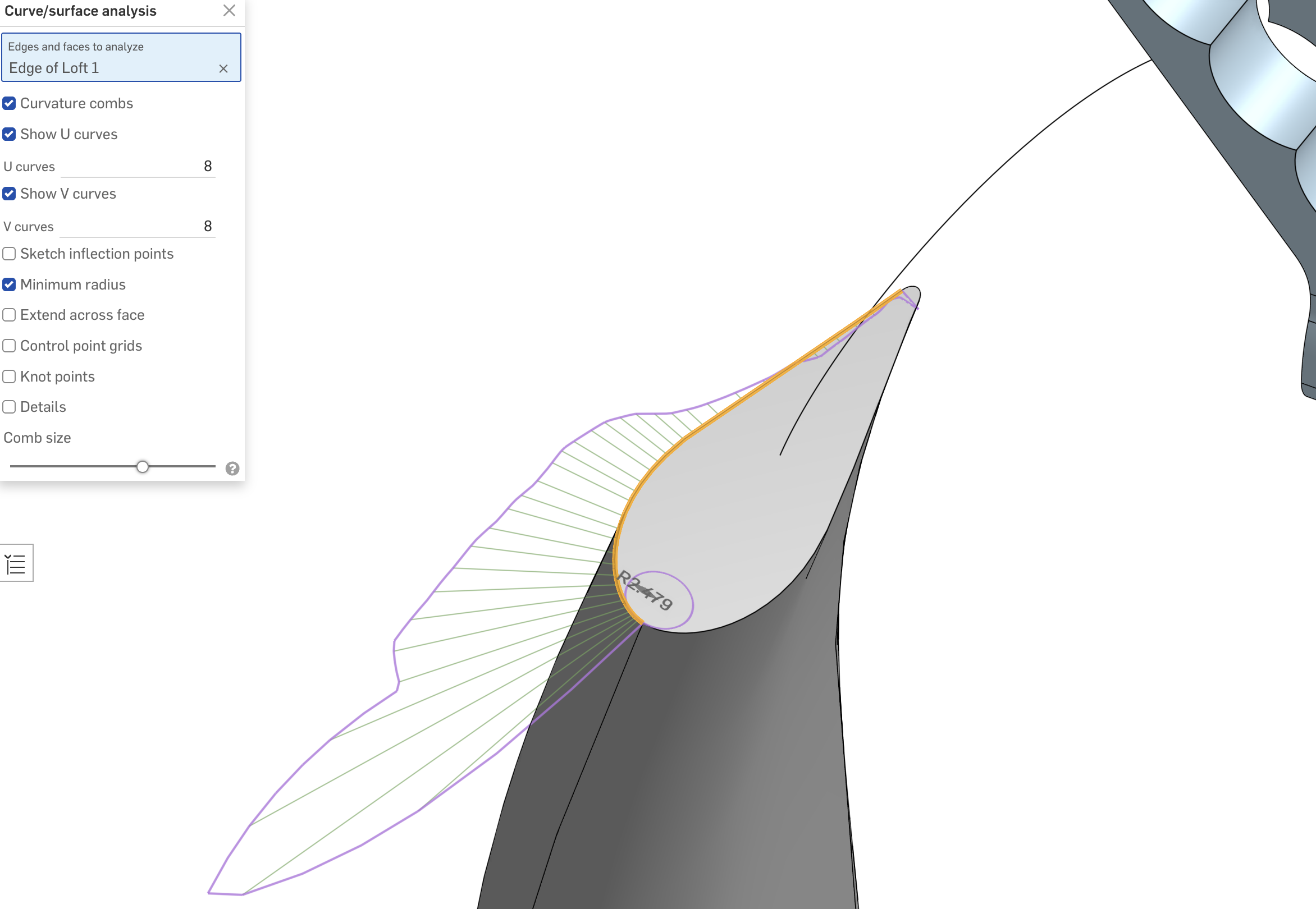

It will take some work to fix it, but big picture: your loft is only as good as the underlying curves.
That's an airfoil shape so I'm somewhat limited in what I can do there. I certainly see how that can be an issue, though. I feel like the edit curve feature will be my friend in the next revision.
That being said, it's clear to the naked eye what is wrong, and since the answer is in the complexity of the underlying curves, is there not a way to push that algorithm into the loft? Since the edit curve works so perfectly to approximate a bad curve keeping the underlying intent, a similar behavior in a surface, to keep the initial and final tangents while simplifying the overall complexity would be perfect.
Edit curve with degree 5 and multiple spans is pretty good at making things smooth.
I would look at adding guide curves that are created using Bridging curve. Paths aren't often great with loft in my experience. I would also look at Loft or Boundary surface and build that transition in multiple steps instead of trying to get it to do everything at once. You're also building off of swept edges and lofted edges which are overly complex.
I would back up a little and try to clean up and simplify every surface or curve. Profile Generator is nowhere near as clean as HAVF. Similarly, Freeform curve was a nice tool, but bridging curve or careful use of edit curve to clean things up would help. Boundary surface will often give you more control over surface complexity than loft.
