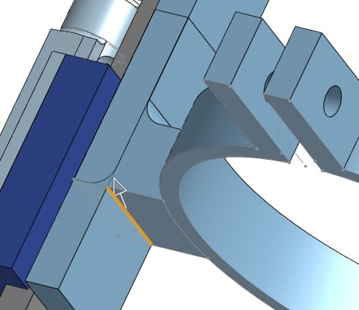

Hi,
I have two identical corners where I want to attach a fillet. It works on the upper corner, but not on the lower corner where the fillet goes inwards.
Why is that?
Kind regards
ProApe
https://cad.onshape.com/documents/1c5beeb06afdeeb7cdcbc514/w/8272fe53c12cc718dec56349/e/5492fb48c3f2e57ff6b26050?renderMode=0&uiState=68a1e59abadd32007aabeacb
The fillet goes 'Inwards' because that part that you're trying to fillet is an individual part. Try hiding Part 1 and then try the fillet again on Part 2
Ok, thanks!
I have missed up a little bit once more ;)
