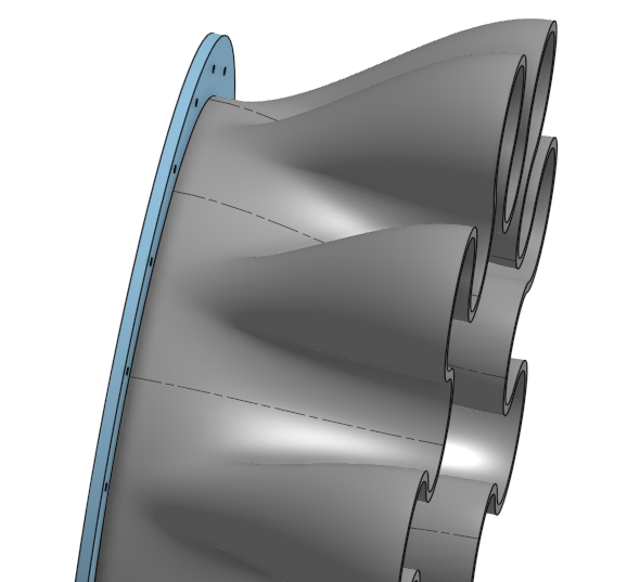

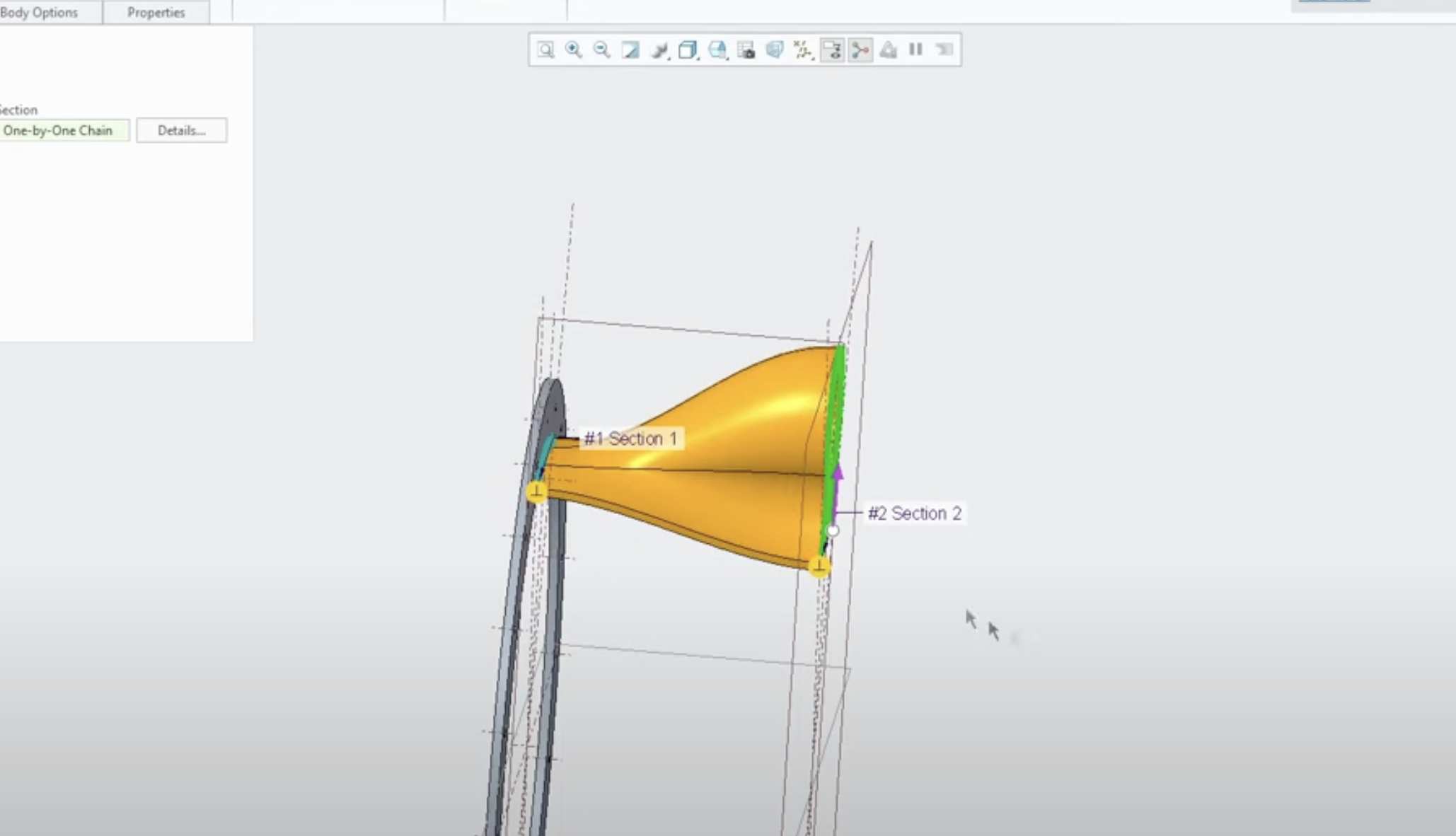

I am trying to replicate a feature from this YouTube video at the 55:07 timestamp-

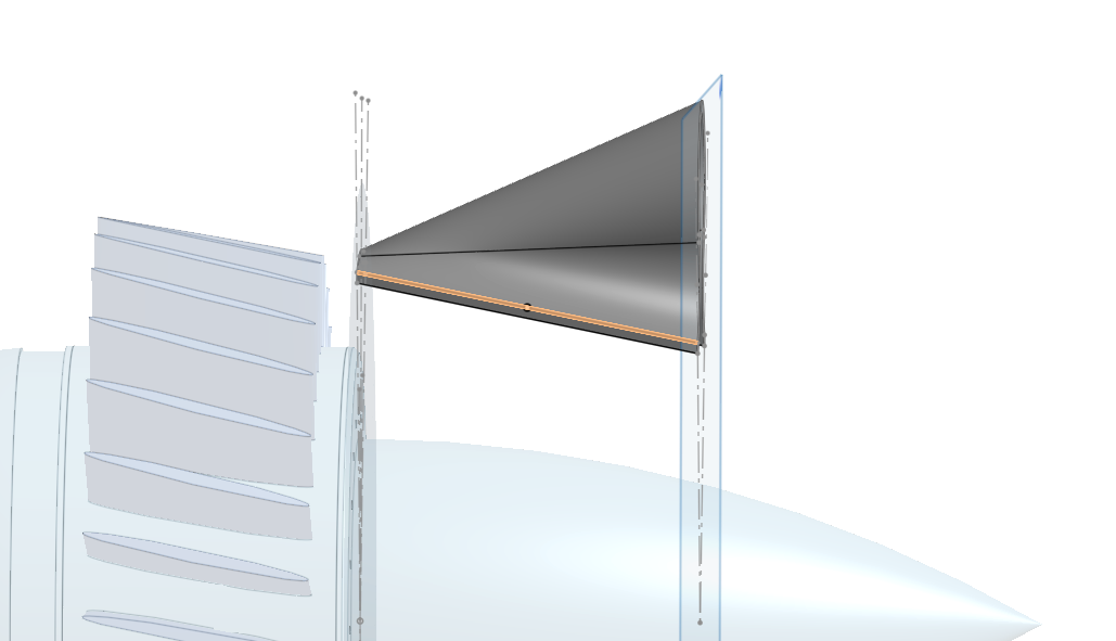

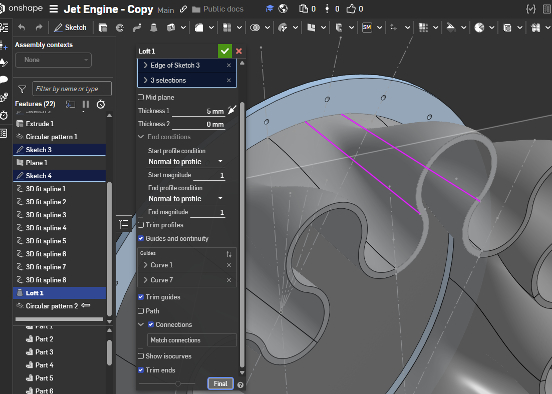

The problem I encountered is that the creator is using PTC Creo and using the Face Blend feature. I was unable to match a same feature on onshape so I used the loft feature and created splines as guide curves in order to create the feature. Although, the video creator adds further finesse to this part by selecting the normal constraint for both ends. I am unable to replicate the same using OnShape. Any idea on how should I proceed or where I am going wrong?

    Your guide curves need to also be normal to the profile in order for the normal loft option to work.
    You might not need the guide curves (or definitely not this many). I would also suggest making this either as a "thin" extrude or as a surface and thicken it.

    Looks like you're almost there. Couple of things I'd recommend to tweak…
    turn off guides in the loft and suppress/delete 3d fit splines as they aren't needed.
    turn on connections and define a corner connection that correlates both sketches.
    set the start and end profile conditions of the loft to normal to profile with a magnitude of 1 or whatever you like.
    switch to add in the circular pattern to make it a single piece with no edges.
