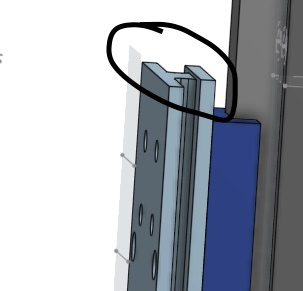

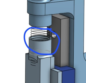

An example of what is missing after the simple changes I made: a cylinder; the screenshot with the cylinder is from an earlier version of the document.
