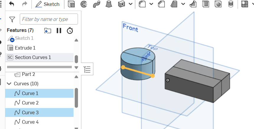

    I debug from GhatGPT, and now it could generate the curves.
    Question:
    1. two box →8 curves (if I select 2 parts, correct, but default will generate 10 curves, some duplicate)
      1. Curve 1 and Curve 3 are the same
    2. How to create sketch with projection these curves?
