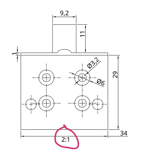

Hello,
For my construction, which turns my CNC milling machine into a plotter, I created a drawing in which the scale and dimensions are displayed and exported it as a .dxf file.

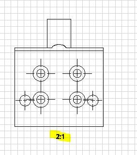

When I open it in Estlcam, the program I use to create the GCode, the scale is displayed, but not the dimensions.
Someone told me that this is because they are objects, but they should be paths.
Is there a way to export them as paths?
As I exported it in Onshape:
As I opened it in Estlcam:
Kind regards
Proape

    When I export as .svg instead of .dxf Estlcam recognises the dimensions. But the result was 10 times to big. What did I wrong?
