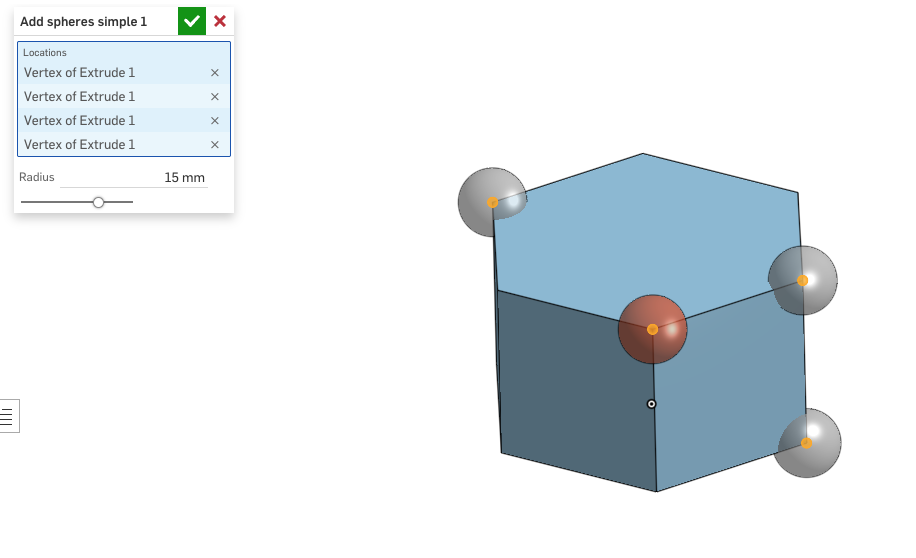

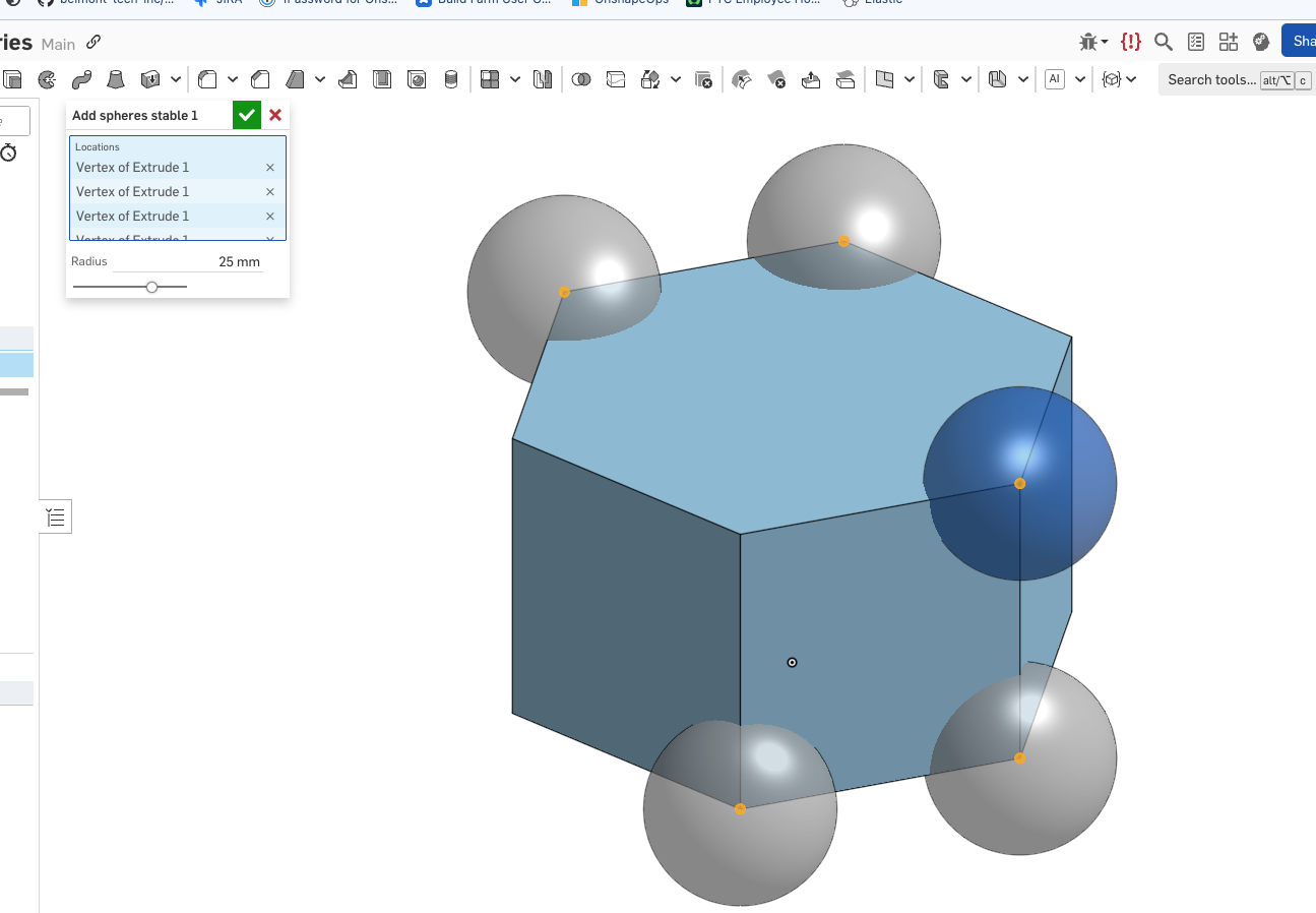

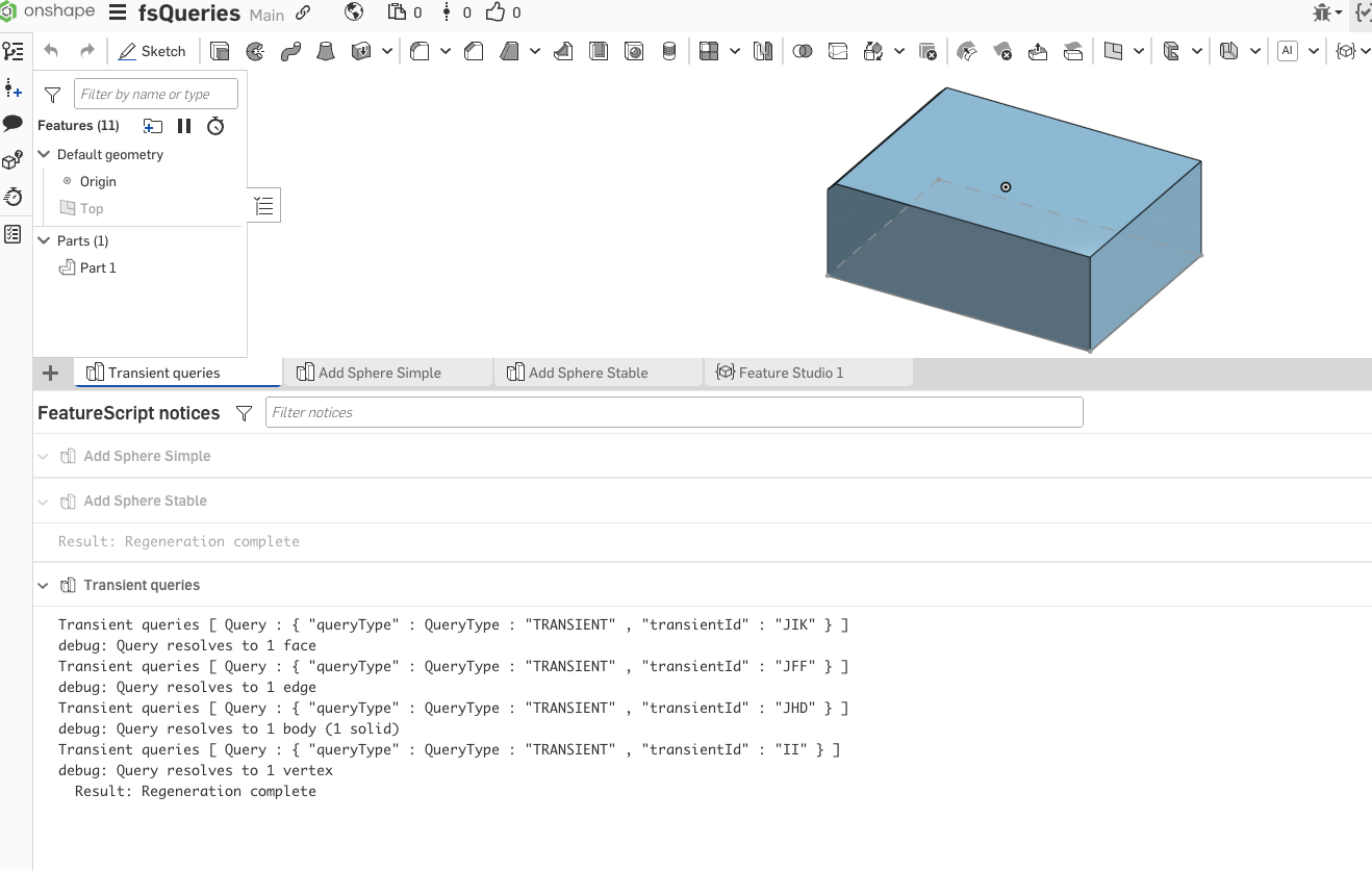

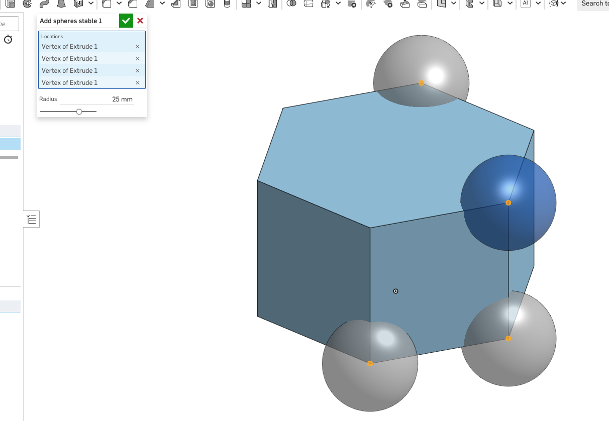

  • lana
    This document has some simple illustrations :
    https://cad.onshape.com/documents/c11f5ce0511835f1be75e532/w/59249a8509a24c1f0c0bd39c/e/bdef6ab7c01a141dc56cc795
    Transient queries are simple handles (transientId field is the important one) which we use to identify topology in current state. They are transient because as soon as something changes, the handles might also change.
    Spheres simple and spheres stable illustrate use of forEachEntity ( which is a convenient wrapper for unstable component and external disambiguation) . In simple case red sphere "jumps" if we delete first vertex, in stable case it does not.
    Screenshot 2025-08-25 at 6.53.22 PM.png Screenshot 2025-08-25 at 6.53.33 PM.png Screenshot 2025-08-25 at 6.57.15 PM.png Screenshot 2025-08-25 at 6.57.28 PM.png
    I know - this is short of explaining what is happening internally, but that is a much longer story - I'll come to it later.

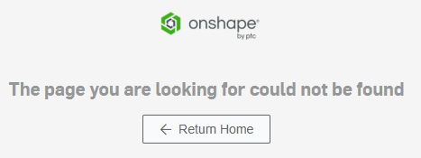

  • christopher_dziuba
    christopher_dziuba Member Posts: 124 ✭✭✭
    @Lindsay_Early
    This is what happens when I click your link.

  • Lindsay_Early
    Lindsay_Early Member, Onshape Employees, Developers Posts: 26 image
    Sorry about that. I fixed the original link in my comment now. Period is removed and it works.

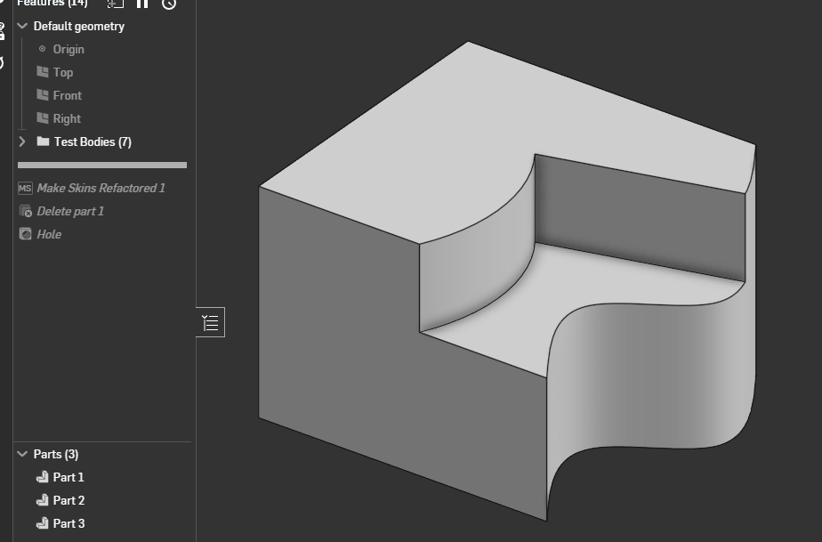

    @Lindsay_Early thanks for following up and I did have a look at your coarse. Although I think it's invaluable for new comers that is very much not what I am asking for. Also the fact that it's a designed for beginners, comes of as an insult to me, although I'm sure it's not meant that way.
    @lana Thanks for looking at my code! That's exactly my problem everything seems fine and then this happens:
    For some damn reason selecting one of the resulting parts force selects multiple parts sometimes! On top of that the skins are still not robust to upstream changes. In other words if I modify which faces are skins anything that referenced those skins either switches what skin was selected or completely breaks! All I want is robust selection after making skin and it's impossible without fundamental knowledge of how ID's are handled in the background.
  • lana
    edited August 2025 Answer ✓
    This Onshape Live presentation had ( a very simplified ) explanation of how queries work inside Onshape. For each topology created by an operation there is a record of its dependencies allowing us to identify this topology. When downstream references this topology, query (an encoding) of this record is generated. Query evaluation is a patten matching of the query with current state of history. One of the first matches is operation id. If we introduce an unstable component into ids of some operations, it means that results of those operations will all be considered when evaluating a query generated for one of them. E.g. If we have a set of operation ids fId0,op0, fId1.*id0.op, fid1.*id1.op, fid1.*id2.op .. , when evaluating a query for topology created by e.g. fid1.*id1.op , we'll consider all fid1.*.op operations. This way reference is stable to order and number of input selections. If the dependencies are not enough to disambiguate results of these operations, external disambiguation is used. At the time of query evaluation external reference replaces the unstable component. I hope this gives you a mental model for the future. This is not going to give you a complete clarity without knowing the way each operation handles its history records. I don't think we are going to expose those details any time soon.
    All of that is supposed to work in theory, but sequence of opSplit where results of previous step are passed into the next does not. I can't say that there is a theoretical reason why it could not, but so far we've fallen short of getting there. I'll add your example to an issue we have for addressing this scenario.
