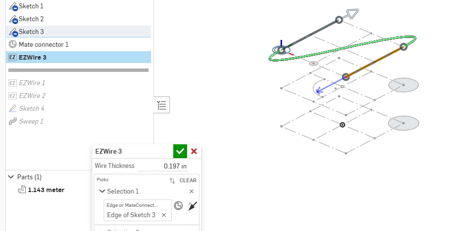

Am i going crazy or is there no way to name a part by a rounded valueWithUnits in the user's own workspace units?

    thank you. maybe one day there will be getWorkspaceUnits or smth.
    EDIT, actually it doesn't work, it's giving me meters always, even though my workspace units are inches.
