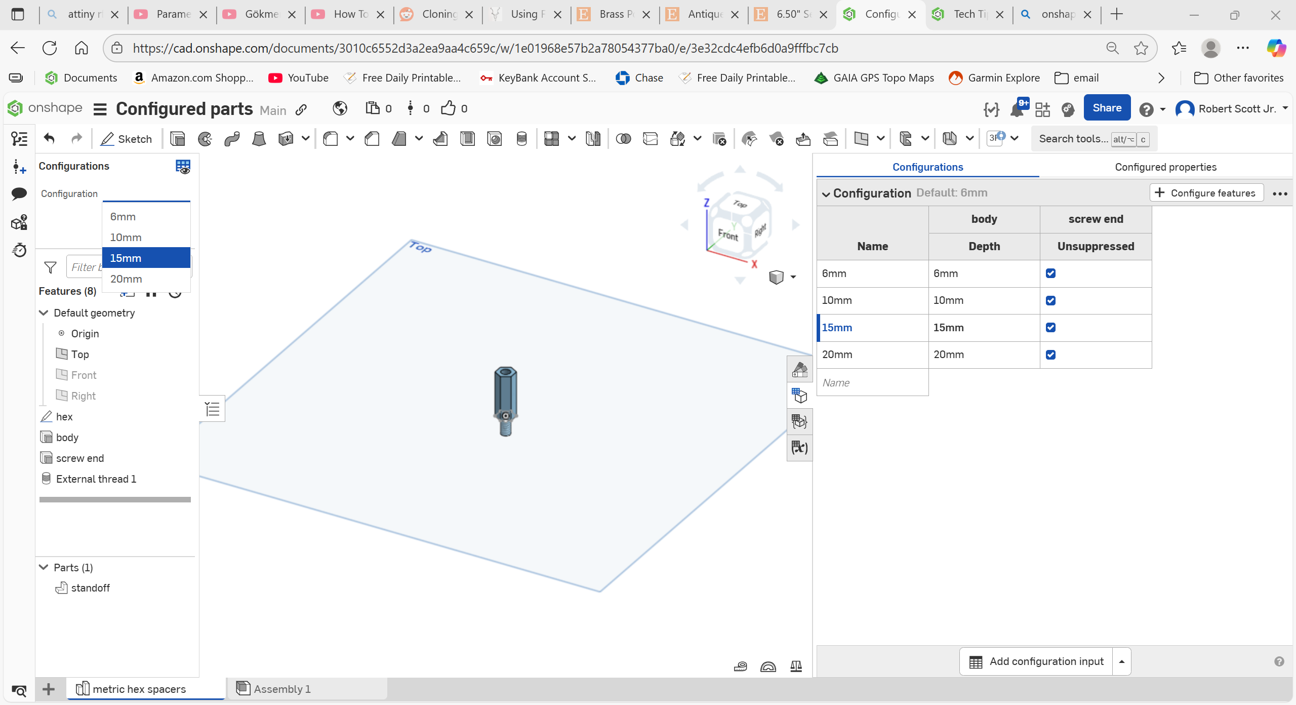

Hello All.
Needing a standoff for a project, I decided to create a document of configurable parts that frequent my projects. For now, only two features of the standoff are in the configuration panel; length of the standoff and whether or not the standoff has a threaded stud on an end.
Only the standoff length is a selection in the feature tree. The extrude suppression state for the stud isn't available. Right clicking on that extrude feature does have an option to unsuppress the feature. Refreshing the browser makes no difference. What am I lacking? - Scotty

You have to add a second configuration input (bottom right button in your image) and configure the suppression of the screw end in there.
Thank You, Eric.
