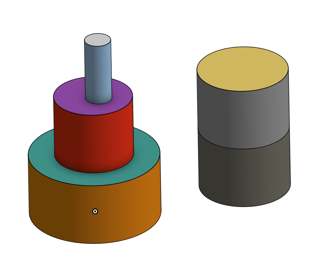

Hello,

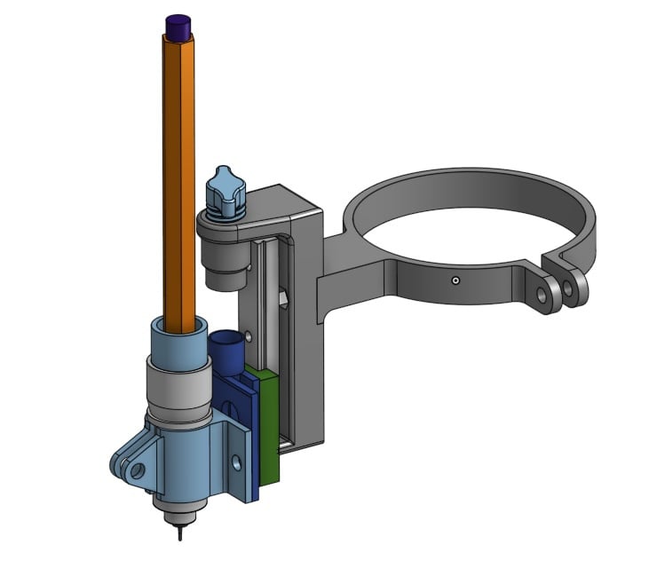

To make my pen holder construction even more realistic, I also designed the pen that goes in the pen holder.
The original, which I traced, had a black tip, an orange body and a blue-violet cylinder on top.
I first drew the three elements as one part because they belong together, but then I could only choose one colour.
So I converted the one part into three and was able to choose the desired colour for each part.
Then I converted them back into one part using a Boolean operation, and there was only one colour left.
Then I undid it again, back to three parts, but in the assembly I have to put them together.
Is there another way to achieve this?
Kind regards,
ProApe

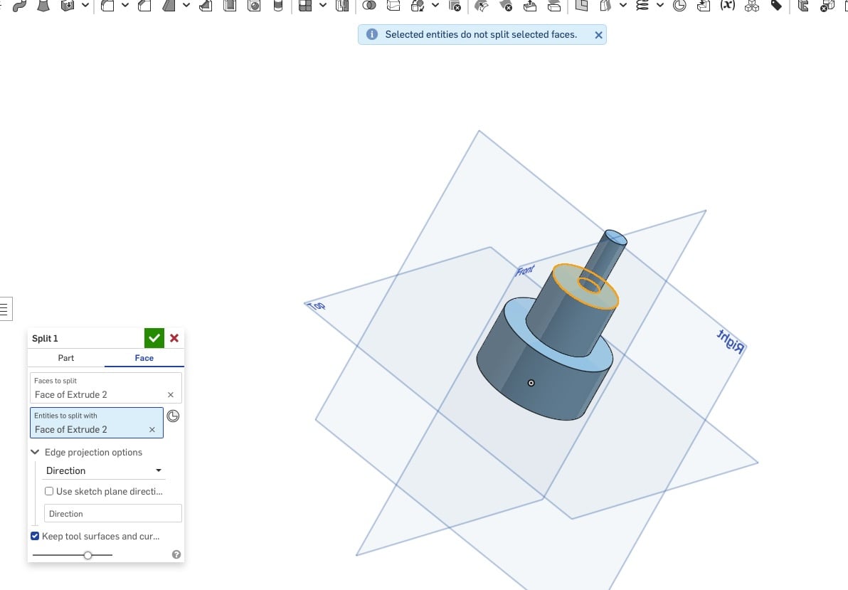

    Not so simple finally: I may not split those cylinders.
    https://cad.onshape.com/documents/c6be626b76a2750c0eef4060/w/014938f5bc8df12db1fcdcd8/e/87de30c6b62ff4a45a413063?renderMode=0&uiState=68b1b62ef4ffed53e77aa39a
  • Matt_ShieldsMatt_Shields Member, Onshape Employees Posts: 933 PRO
    You can add appearances to individual faces.
  • ProApeProApe Member Posts: 232 ✭✭
    ok, that worked! Did you try to split the 3 cylinders? The other one I didn't have problems to split it.
    I didn't have to split anything. Just right-clicked a face and selected "Add appearance to face…"
    Yes, I understood and it worked, but I should first split the part in 3 and that didn't work, as for the uniform cylinder it worked without any problem.
  • MDesignMDesign Member Posts: 1,329 PRO
    You only need to split the face not the actual part.
