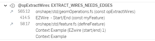

How do I pass on "internal" errors to the user?
For example, if they try something and it says this in the console, can I capture that error and post it as a reportFeatureWarning?
Also, the documentation is pretty bad for try/throw/catch (for a non programmer). what is the "e" catch (e)? What does throwing "e" do?
