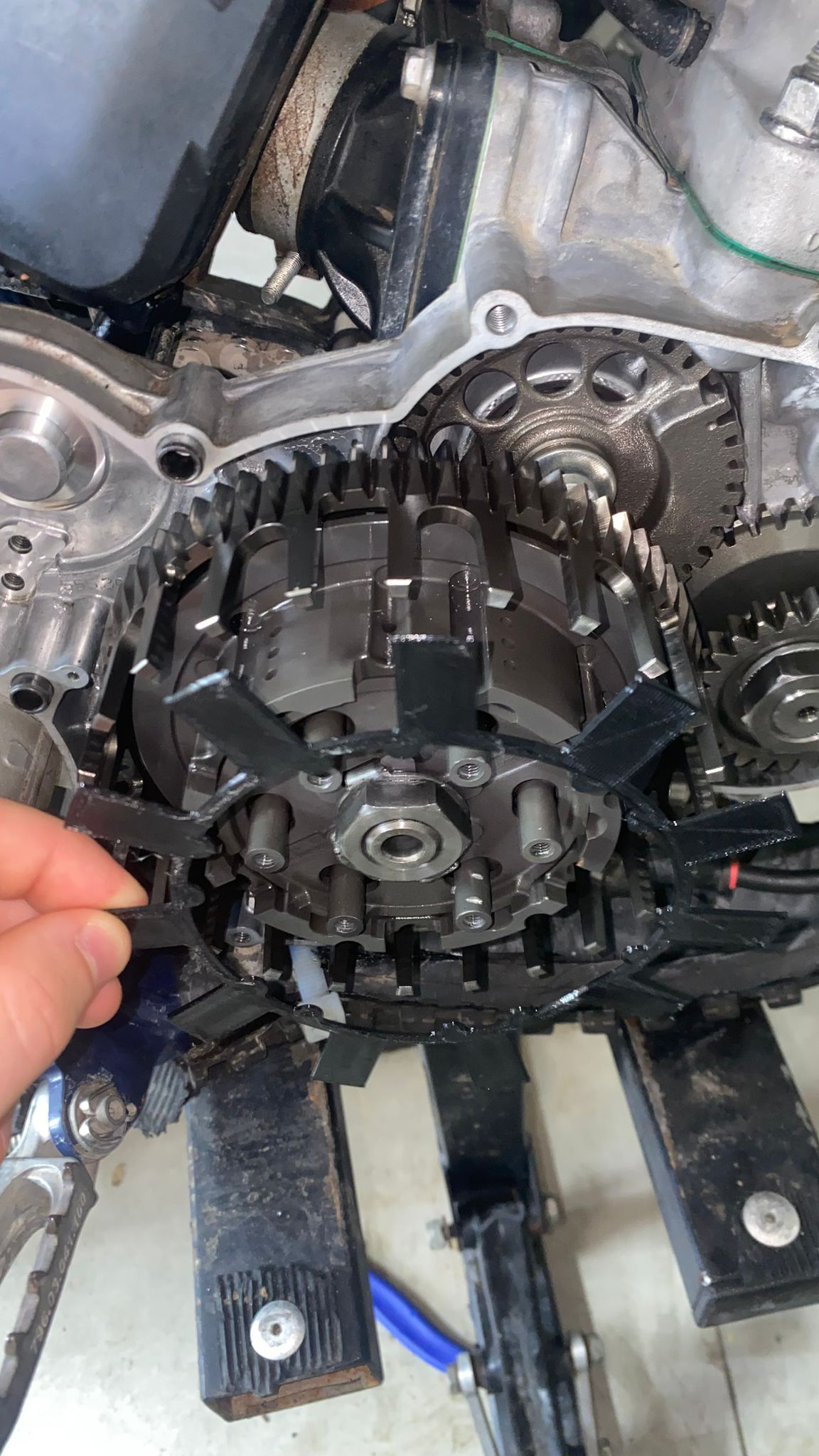

Hi, Im trying to get the gear spacing right to make a tool that holds my bike clutch and Im having a hard time trying to do so

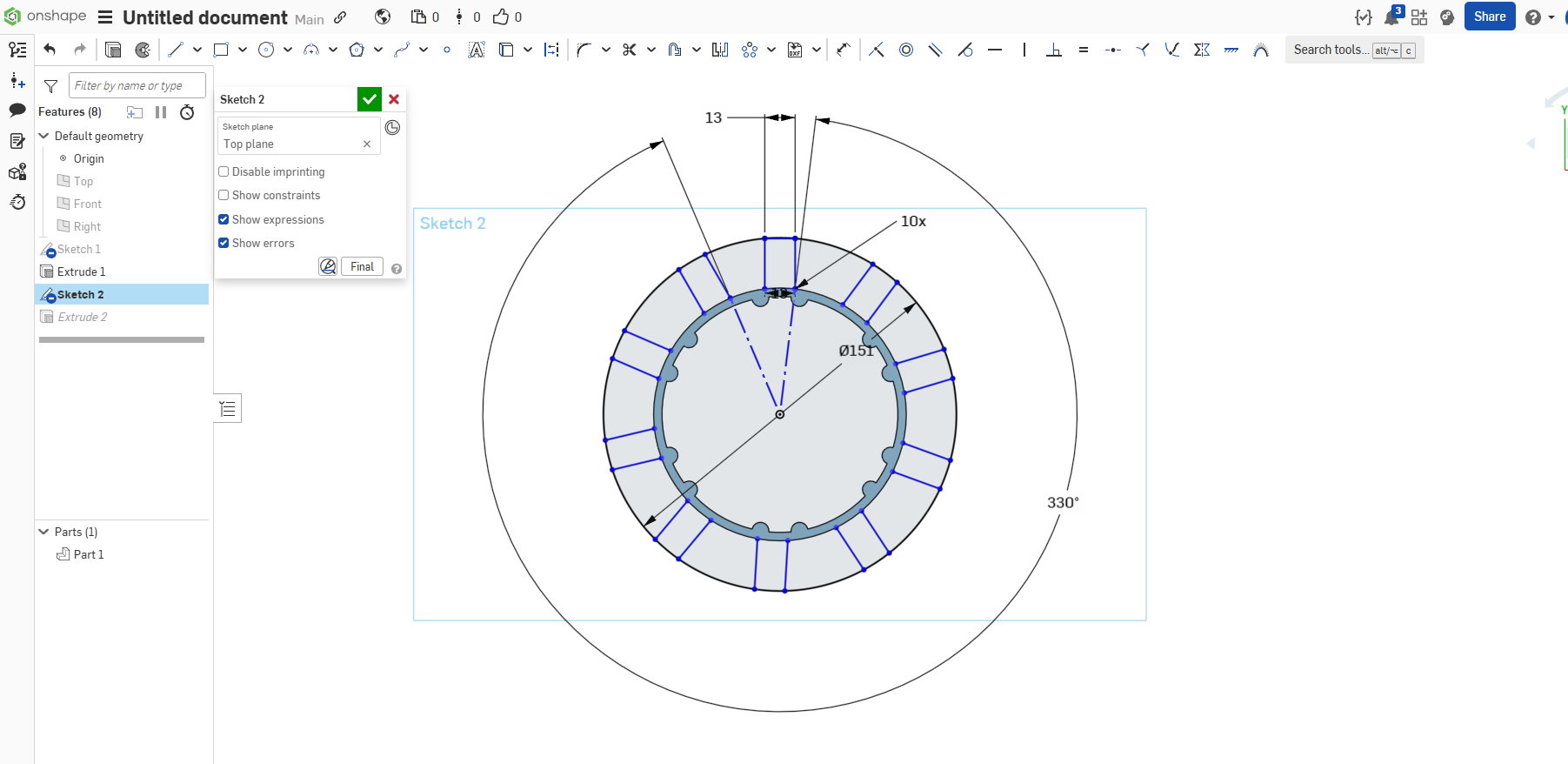

How can I determine the spacing, for example if I want 14 mm between each teeth?

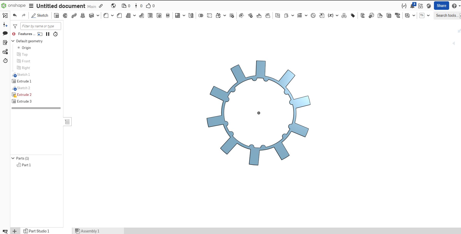

I cant get even spacing when using the circular pattern

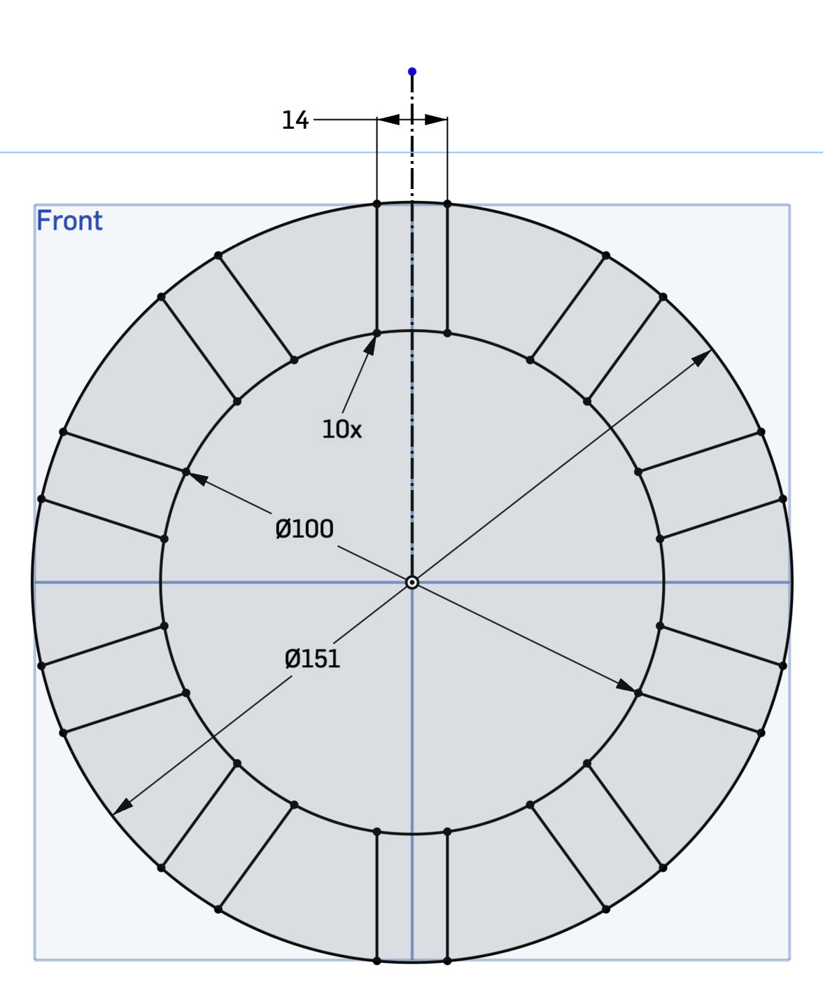

  • Matt_ShieldsMatt_Shields Member, Onshape Employees Posts: 942 PRO
    Not sure I understand your question correctly, but if you circular pattern the full 360, it will figure out the spacing for you.
  • rlbrkrlbrk Member Posts: 31
    Thank you, thats what I did and it worked
