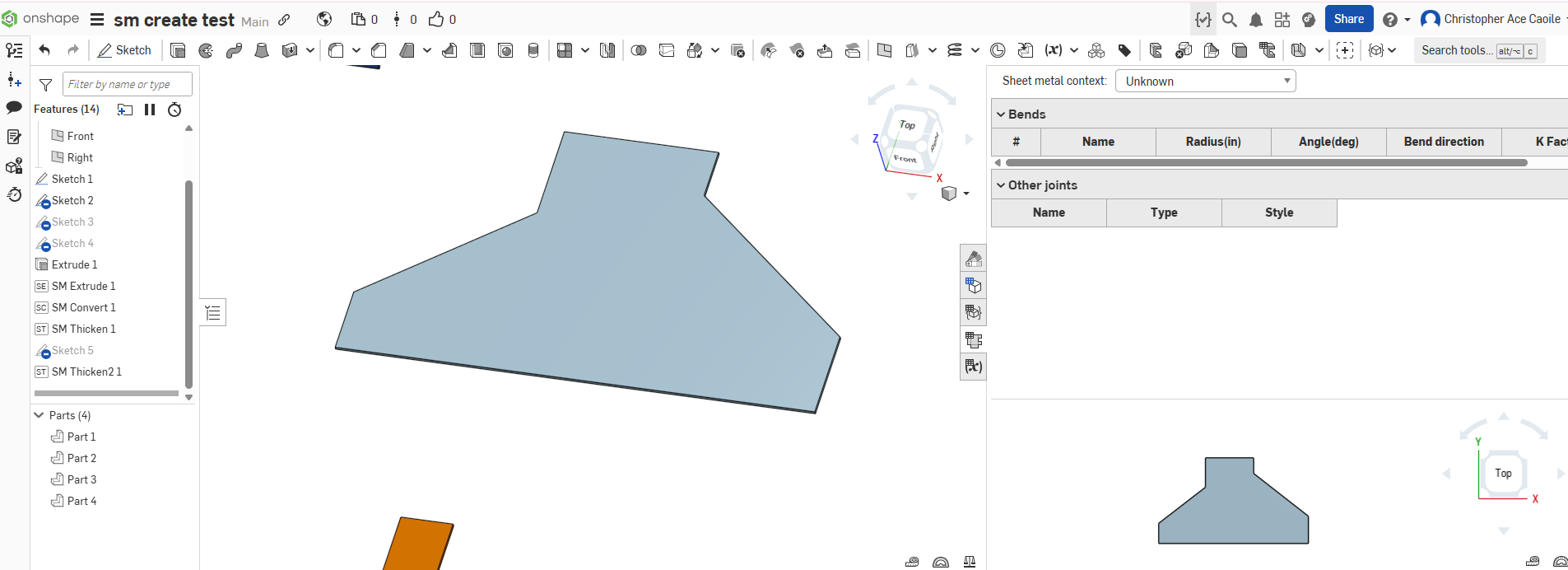

Hi All,
When I create a sheet Metal object via feature script. In the sheet Metal Context window, It shows "Unknown" instead of the usual "Sheet metal model 1"…
How do we control this behavior in featurescript?
Thanks in advance!!!

    Hi Caden,
    I constructed the script above just as you suggested but I'm still running into the same issue.. I'm getting "Unknown" in the Sheet metal context window instead of the normal "Sheet metal model 1"
  • lana
    That piece of UI is specific to the standard sheetMetalStart feature. I don't think you can coax it to work with your feature. Sorry.
  • Derek_Van_Allen_BD
    Derek_Van_Allen_BD Member Posts: 1,165 PRO
