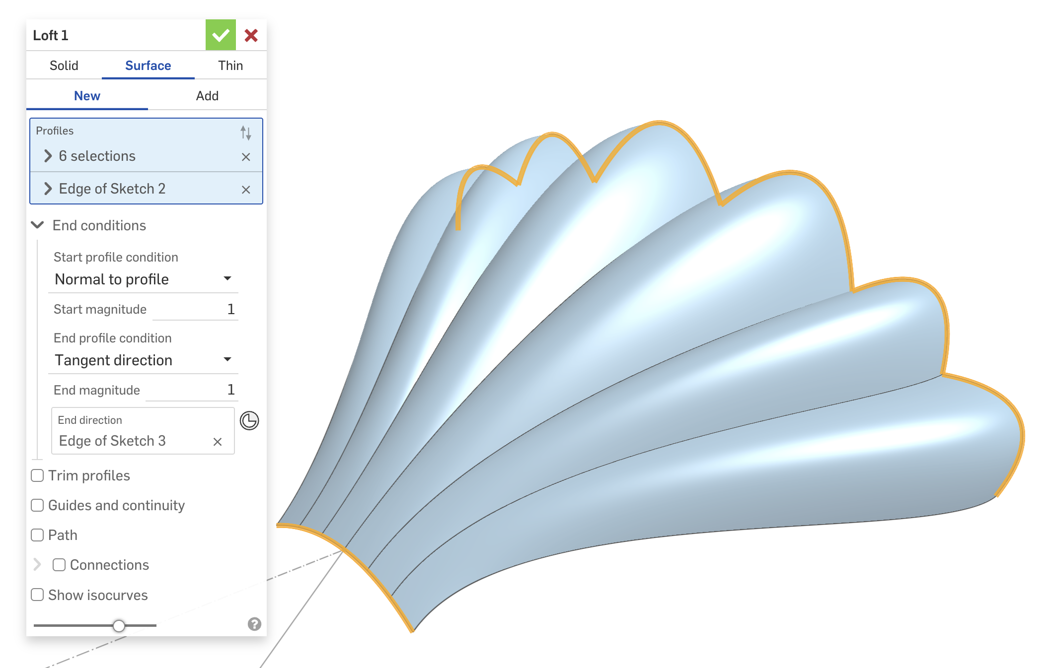

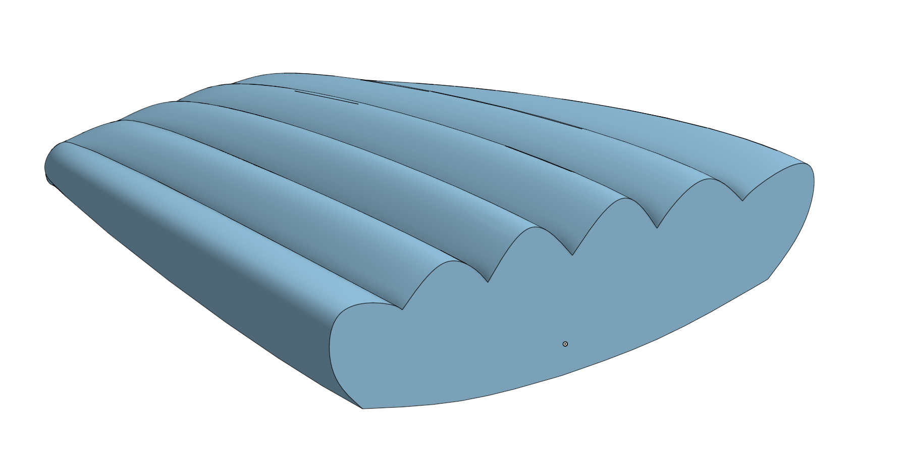

I've started learning to model in onshape and thought a good test would be to try and create some seashells with complex curved surfaces. This is proving to be difficult: with the various Loft options only making some sense as I furiously click through all the possible options. I'm try to close a scallop-like shell (below) by lofting the flat face to a point (or a selection of points), resulting in compound, soft domes shapes which smooth off the solid.
However, I cannot find a solution using only points and have found only unsatisfactory solutions by lofting to various new sketches. Does anyone have any advice on lofting smoothly to a point or set of points? Is there a better approach for creating parts where all the surfaces are curved and there isn't much constrained geometry to reference?

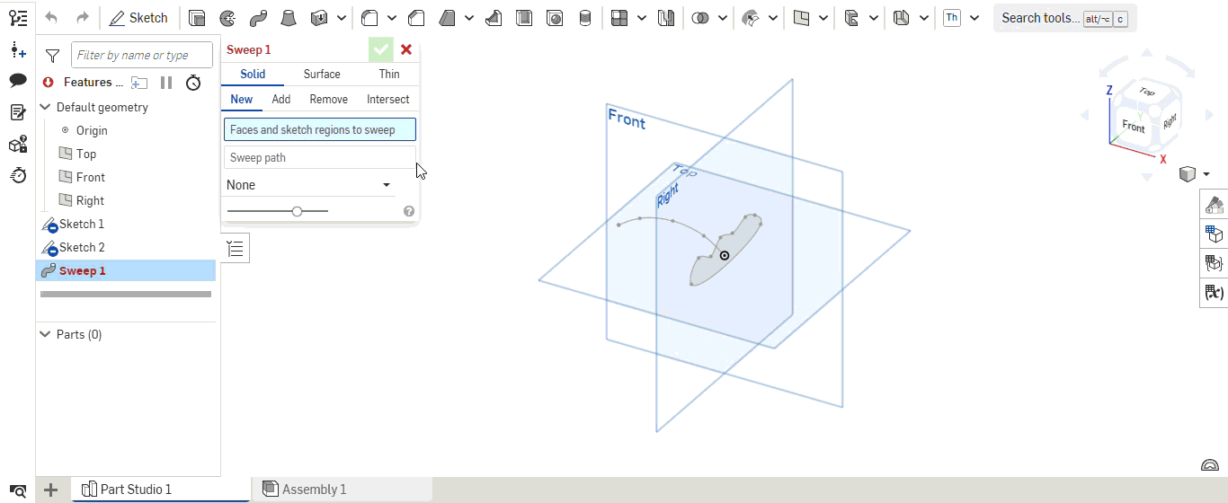

    If what you want is to create a object entirely out of just points the simple answer is no you can't you need a surface to create a object. As for creating a surface that is curved like a seashell would be without loft and as fast as you can try to use the sweep tool like I used below:
    and for more effect if you don't want the ends to look flat you can just use the revolve tool to give a spherical end to it
