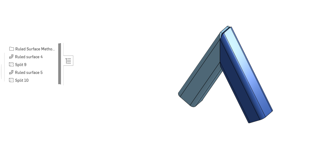

I've been working with some laser cut tubing recently, and have had to go back and forth with suppliers about normal-to-surface tube cutting that doesn't exactly match our model. I've found guides for normalizing coped and mitered cuts on round tube, and used them to come up with a process for transforming a tube modeled with the Frame features (with limited ends) into a normal-to-surface model ready for fabrication:
  1. Create a ruled surface from the outer edge, normal to the outer surface, towards the center of the tube.
    1. This step isn't in the guides, but the outer edge surface is needed with angled copes or miters to prevent part interference.
  2. Create a ruled surface from the inner edge, normal to the inner surface, towards the outside of the tube.
  3. Split the part from the Outer and Inner ruled surfaces (in that order).
I think this would process would be ideal for a custom feature, but I haven't learned FeatureScript yet, so I naturally turned to vibe coding. I'm starting with very simple constraints - round tubes with coped and mitered cuts, but would love to expand to more complex cuts or rectangular tubing in the future. After a lot of back-and-forth, I've gotten the feature to successfully create the ruled surfaces from the cut end, but I can't get opSplitPart to split the frame parts with the ruled surfaces. Any direction on how to get this to be functional?

    My black box of vibe code suggests the following fix for your split operation:
    Something like this feature was on my to-do list for frames, I'm glad someone else is working on it, I'll probably be working from this as a starting point because the ruled surface inside / outside + split operation is the exact working principle I was going to turn into my script when I got into it.
    Edit: Here's a link to my copy of your doc that implements split direction keep logic as well so you can skip the delete bodies logic.

    That was the issue! The split direction logic also worked well. I had the same thought about selecting only the end faces. I'm working to expand to more complex cuts (i.e. a V-notch to mate with the corner of a square tube).

    I played with the idea of ruled surface and cutting the tubing we're using right now, which is ANSI 0.75" X 0.75" X 0.125". It has 0.038" fillets. I'm not clear on how a ruled surface, normal to the outside, would work with tubing where a fillet is less than the wall thickness. Depending on the design intent, there's likely a way to model the result, but there's not a simple programmatic solution to this, unless maybe the FS made a copy of the outside and deleted small radii like that. I'm also not clear on what would happen with a real tub cutting machine. I've only ever seen videos of them in action, and haven't designed anything with them as part of the production process.
  • BenTaylor
    BenTaylor Member Posts: 51 PRO
    I was able to add selection for multiple end faces and removed the part selection requirement, but I think that's as far as I'm going to take my FS at this point. I tried to repeat the process manually with rectangular tubes, but couldn't figure out how to do it with ruled surfaces because of the external corner radius. Excited to see what you can figure out!

  • josh_mandel
    josh_mandel Member Posts: 8 PRO
    If dug into this a bit and the best way I found is with Ruled Surface and than Split. I needed to do that once for the inside corner and once for the outside.
    https://cad.onshape.com/documents/e35c25a540adc3a8b8ec048e/w/ddeb2743aacd3fa029c1880f/e/4f4ad935ba25f1d1c0ae82db?renderMode=0&uiState=69b1fbb68c80cbfcfecda1dd
    Hopefully this link works the new method is called Ruled Surface Method 2
