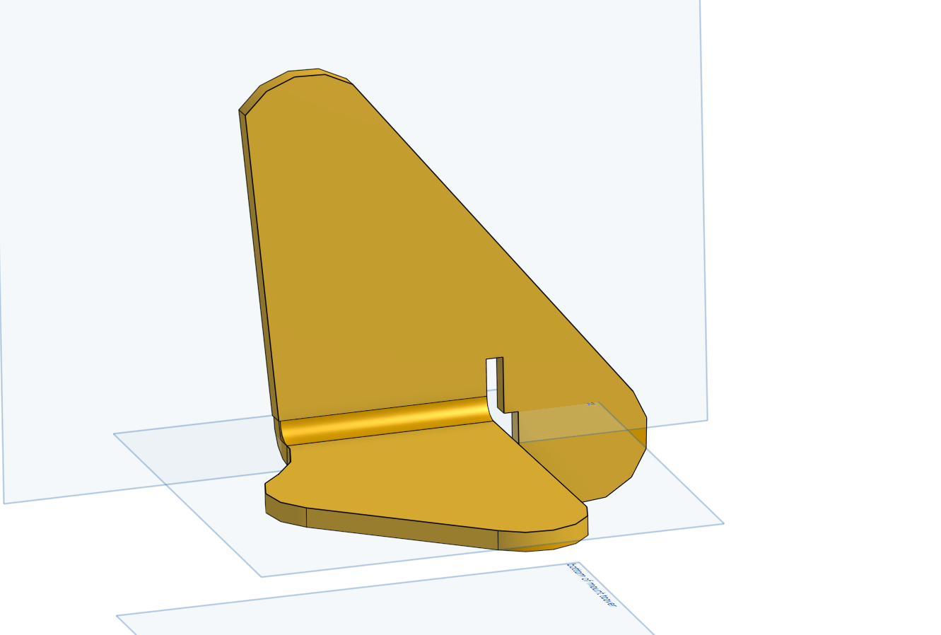

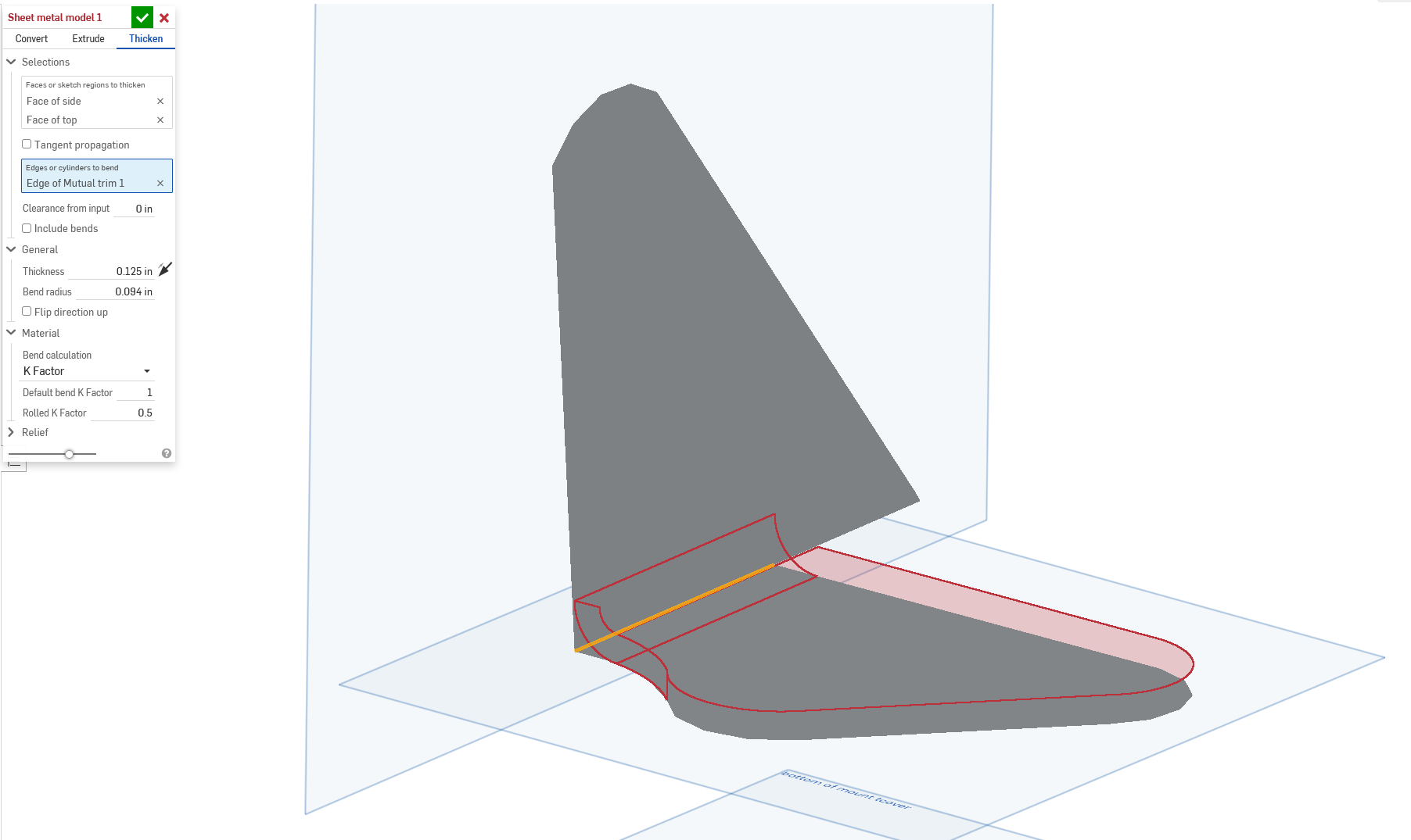

Hi. I'm using these two surfaces, which have been joined into one using a mutual trim, in order to make a sheet metal part. it's giving me a headache about it for reasons I cannot figure out. The planes are placed on 3 vertices of a 3D scan and are pretty close to perpindicular, likely not exactly. Though I've made sheet metal stuff with non-perpindicular faces before.
https://cad.onshape.com/documents/b33f95806652c9ebc4be30af/w/4d2bac52cfb942d186b9b072/e/e0a9f2b7c13194857acff572?renderMode=0&uiState=68c25dc3a8a4463b014e14c3
    The faces are flat i take it?
    It probably doesn't know how to deal with the sudden step in width that is coincident with a bend line.
    try trimming a triangle off the face on the right side there to double check if that's the cause.

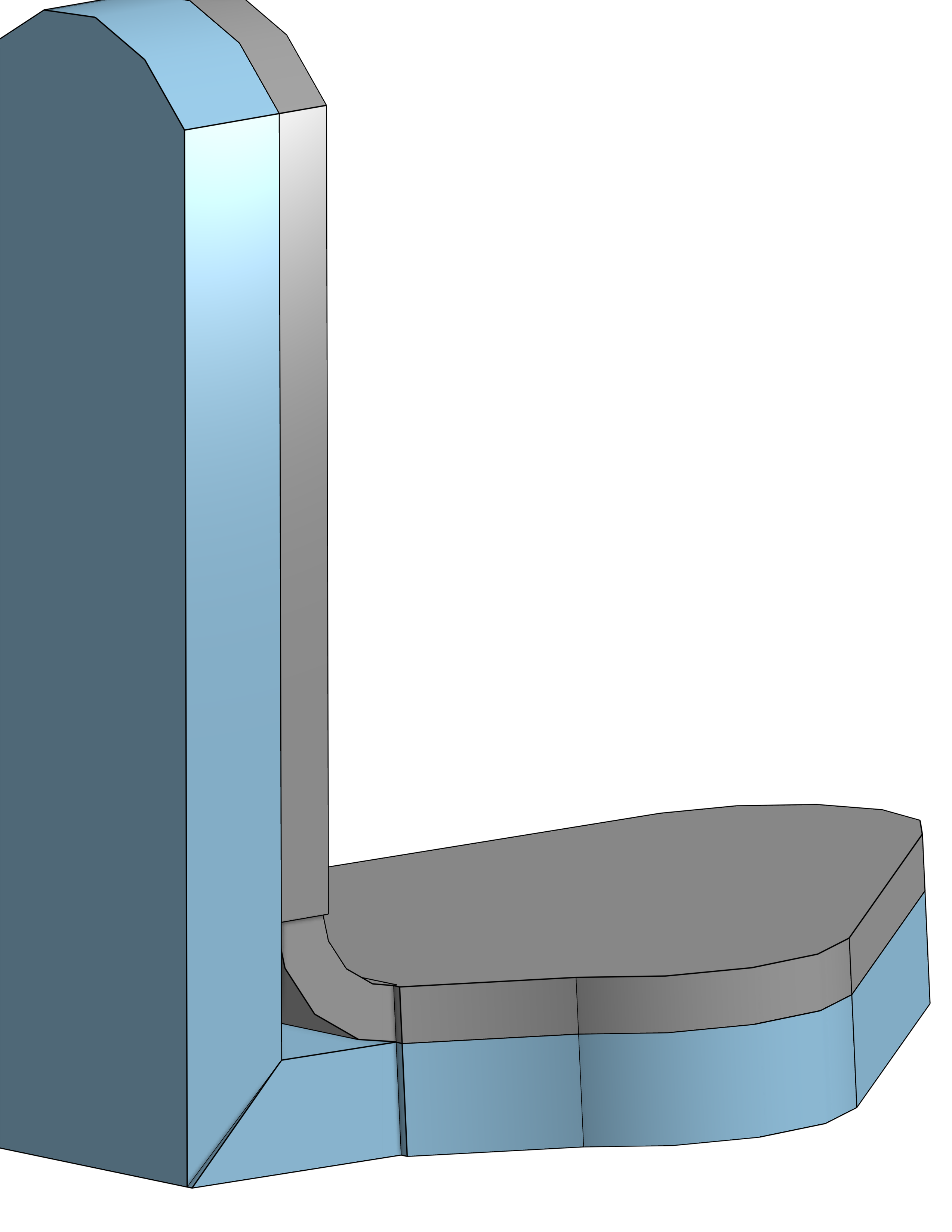

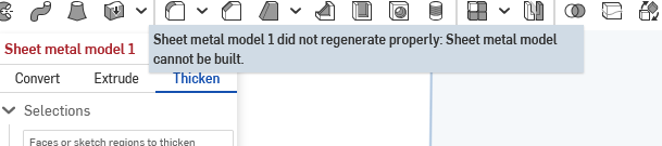

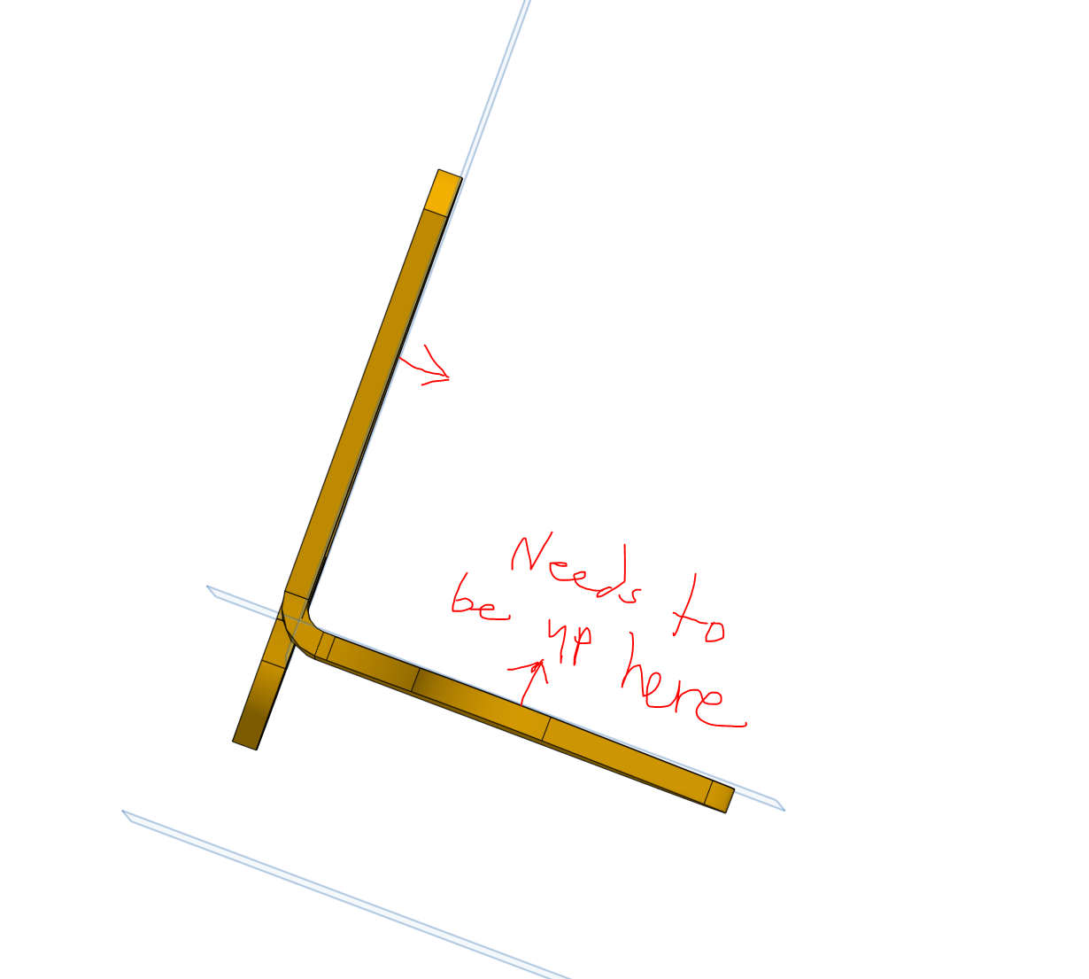

    You're definitely onto something. I added a relief to the end of the bend and got this. The problem is, when I invert the thickness to be on the other side, it cannot build the model all of a sudden. I even tried making a solid part to use the faces off that. Same issue. Is there a way I could chop that triangle section off and add the rest later I wonder.
  • wayne_sauderwayne_sauder Member, csevp Posts: 651 PRO
    @heep_xj
    You have something odd going on in this corner. I was able to get it to work by cutting out a piece of the radius leading into the corner, but ideally, you should probably rework the part a bit. Maybe modify the top bolt sketch.
