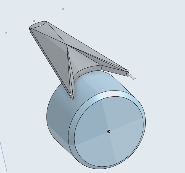

How to wrap a loft around a cylinder
So I'm trying to wrap this triangular figure around a cylinder but it will only wrap the bottom portion and not the top of the triangle.
  • MichaelPascoe
    MichaelPascoe Member Posts: 2,958 PRO
    Onshape doesn't currently support part wrap / flex / bend, only surface and sketch wrapping.
    However, you can use the Thicken tool to thicken your wrapped 2d surface into a 3d part, then preform another loft to a point, in order to get the shape in your image.
    If you need more specific help for your model, please share a link with copy access to your document.

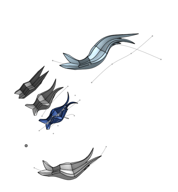

  • Derek_Van_Allen_BD
    I put a decent chunk of work into a flex feature but have run up against a bit of a wall with the base level functions available in featurescript at the moment. I stepped away from it to wait for new transform types or a new surface approximation routine that works closer to the approximate curve function. Then I ran into this SIGGRAPH whitepaper that made me reevaluate the approach, which probably still requires some low level @ functions to be implemented before it's viable.
    S1mon Member Posts: 4,612 PRO
    Parasolid has functions for warping/flexing whatever-you-call-it. Onshape needs to turn them into features.
    I'm not even talking features, I'm just waiting for kernel level functions and I'll start bringing the features.
  • Konst_Sh
    edited September 2025
    long ago i created this feature for non linear transform, since that moment a lot of improvements to fs standard library was made, so now it could probably be made more accurate and faster
    https://cad.onshape.com/documents/9ff305db25363ff0444ebe9a/w/b824d93d849130bd901b55c8/e/37c26eb799d0394a28bb4075
