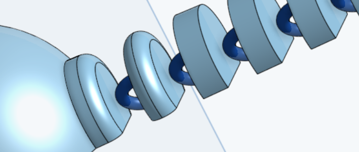

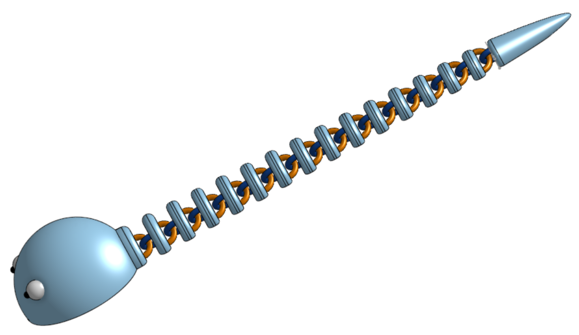

This is a worm. It has #segments in its body. I have shown fillets here. I need to repeat each (front, back) fillet #segments times. That number is currentlly 15, but think of that as being a Configuration parameter and it can vary from, say, 6 to 30 (which is about the maximum I can print diagonally across my print bed).
When I select a linear pattern, the entity to pattern apparently cannot be a fillet. I also realize I may have to venture into scripting language to do this. I would prefer to avoid this as my student is 14 and not a programmer.

    You are seeing half of the attachments in the image I included. Here is the finished image, with each segment individually filleted by hand.

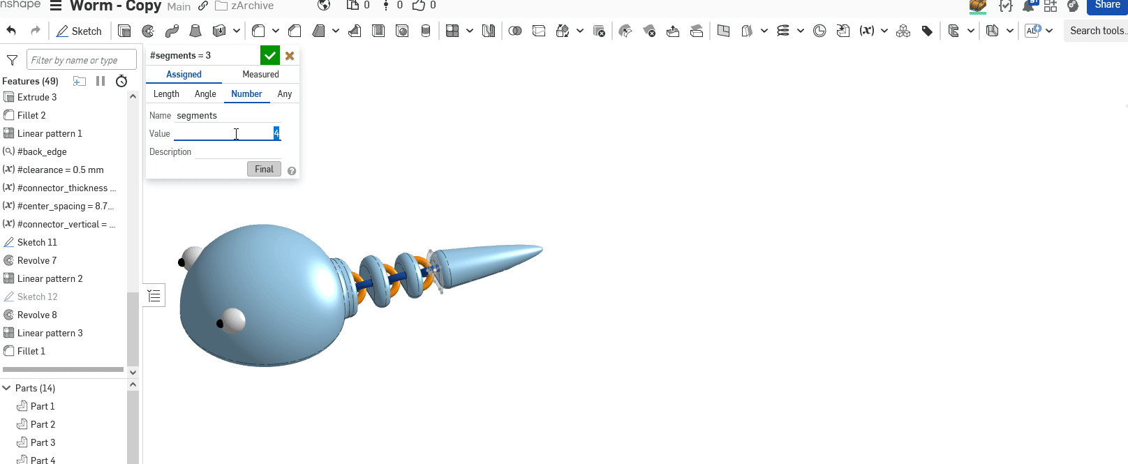

    OK, I have been experimenting for an hour and can't get anything I tried to work.
    I called this #back_edge, and the idea was to replicate the fillet on the back of the head segment all the way down the worm. Then I would create a symmetric one called #front_edge and put a fillet on the tail which would propagate forward. #segments is the magical number.
    The worm body was formed as a single tapered object and then sliced into segments using a Remove linear pattern.
    The last thing I tried was a bounded surfaces pattern, which is what you will find in it. Key here is that if #segments is assigned a different number, we will get all the segments filleted on both sides. Eventually, a more worm-like body sheath may be developed that hides those connectors.
