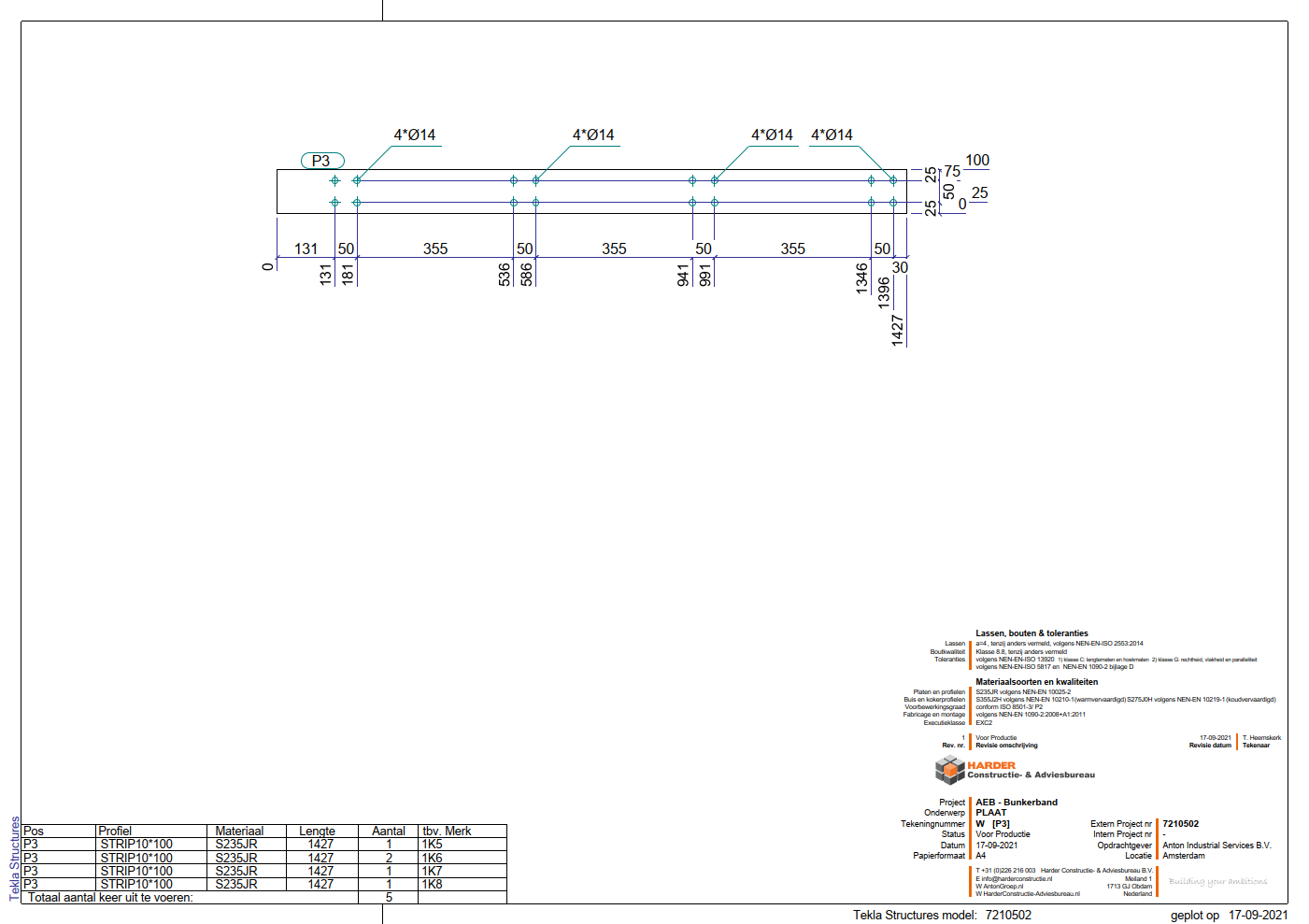

I’m currently comparing Tekla and Onshape and I’m wondering if it’s possible in Onshape to place a Bill of Materials (BOM) directly on a part drawing, similar to how it works in Tekla.
In Tekla, the part drawing immediately shows:
  • Which assemblies the part is used in
  • How many times it needs to be produced
This is extremely useful for production and planning, since you don’t have to go back to the assembly every time to check that information.
